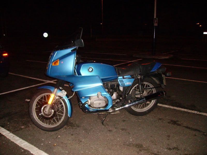

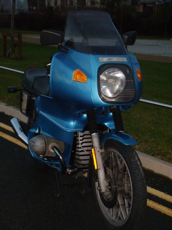

« Reply #11 on: November 08, 2008, 06:16:30 PM »
At last.
Family probs have limited fairing work to a couple hours at a time. But today I had the whole day to myself. Managed to finish the fitting and get everything safe to ride by 3pm. So at 4pm as the sun was going down I set off to Manchester for a test ride. while everyone else celebrated the execution of Guy Fawkes. I wore my usual touring leathers and took along unlined waterproofs for the usual expected downpour. Bars seem cumfy enough for me. Wind pressure is all but gone. Consequently, cruising speed is greatly increased  :) . Cornering, narrower bars and the fairing give a more planted, 'on rails' and stable feeling then previously. Which I don't like, because I know the front tyre is overly skinny and that's the feeling which creates false confidence. So, carefully does it. As I crossed the Penines on the M62, Firework displays from a couple of early bonfires, rightly added some celebration to the run. The flip up windshield provided a bit more protection than the standard screen, but I'm not sure its for me. There's a fair bit more noise of the flip up, even with ear plugs I think it'll be unacceptable over a days riding. Another minor prob surfaced when I came to park in the compound at Manchester. There's a lot less steering lock now. I had to saw backwards and forwards a half dozen times to park in a space the R65 would've slipped into much more easily before the fairing. The rain was falling an hour later when I set off for home. Weather protection from the fairing is good but I still need to put the waterproofs on.  I caught occaisional whiffs of woodsmoke drifting across the motorway, from more bonfires that were now burning. The rain became torrential as I entered Yorkshire, but the firework displays continued regardless. 'focus on riding and stop gorping at the starbursts'. I was saying to myself.
I fitted the fairing to make riding more comfortable in the English/ North European climate and I certainly haven't been disappointed. Todays run was a good trial in British weather and I arrived home after 220 miles so much more comfortable than I would've in prefairing days. plenty of minor adjustments still to be done though.
« Last Edit: November 08, 2008, 06:18:31 PM by larstorders »
aussie
Re: r100rs fairing
« Reply #12 on: November 08, 2008, 07:00:49 PM »
Looking good larst! I'm sort of assuming that you had the fairing painted - or was it just blind luck that it came in the same colour as the bike?
How would you overcome the noise? Put on the stock windshield? Wouldn't it then have the issue of buffetting?
