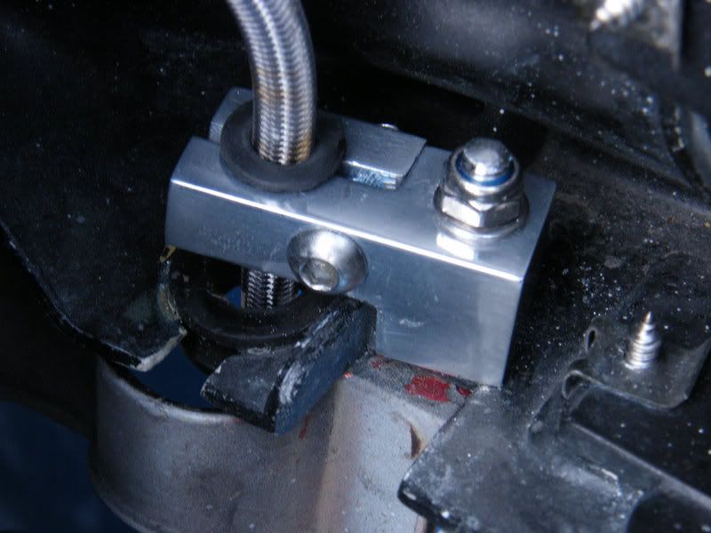

Brake hoses, Hmmmm, I moved the brake hose distributor down onto the horn mounting lug as in picture (please excuse rust, all was cleaned and repainted before final fitting, of course  ::)) In this position I found the length of the lower hoses were exactly the same as the original R65 lower brake hoses  :), the top hose is longer. I fitted new anyway, because on close examination cracks were found in the originals. The horn is now mounted, temporarily on a bracket from the second fairing mounting bar which is positioned 'amidships'. The fairing does not allow enough room for the horn to stay in it's original position, anyway.

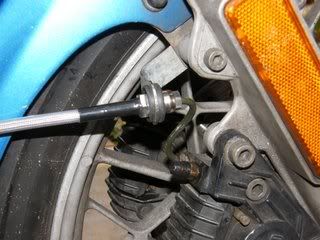

I used stainless, single sided, RS fork leg brackets, from Moto-Bins, to get the correct angle for the hoses as they reach from fairing to fork leg, bending the original caliper brake pipes to meet them was no problem.
Ensuring safe routing of the hose through the fairing was an excuse to make cute little 5083 aluminium brackets.

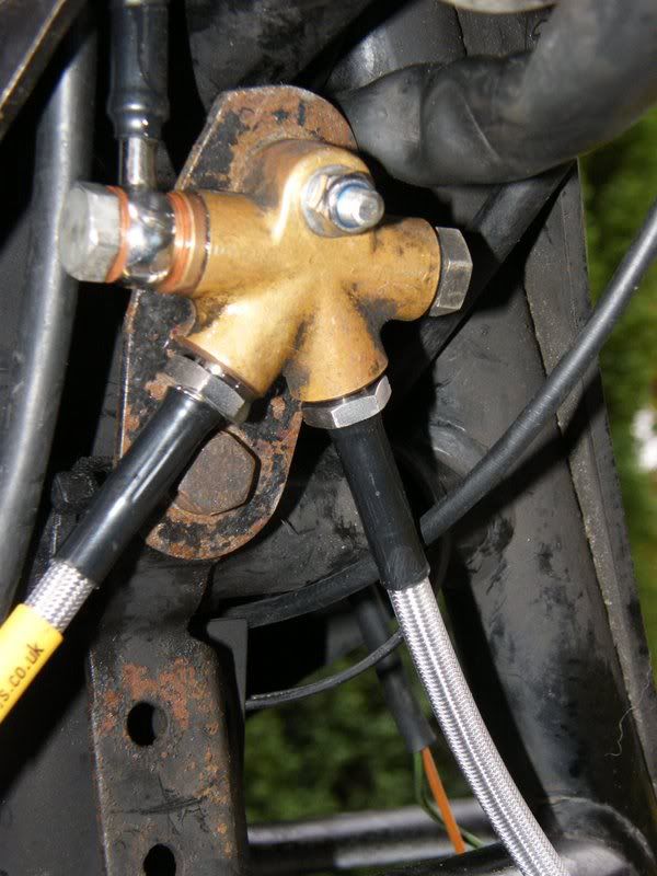

Hasty and uninformed decisions - the story of my life: Moto-Bins delivered the two ss brakehoses I ordered and they do not fit the distributor as they have "female" connectors at both ends. The problem may be solved by reusing my old R65 brakelines to connect the hoses to the distributor as in the attached photo.
Apart from the esthetical aspect are there any safety issues involved in this solution?

Trolle, other then the "ugly factor" I don't see that you should have a problem with that as long as there won't be any strain/flexing on the metal tubes.  The RT (and probably RS) had lengths of metal tubing from the splitter to the fairing.  This plumbing is hidden by the fairing and the ends are captured by a rubber grommet in the fairing so no strain is put on the rigid piping.

You could always return the hoses for a refund. Brakes are crucial. If you think they're not quite right,
then they are NOT right.
As we're dealing with R65 conversions,  components from R100RS etc, often do not fit, especially brakes. Which I found quite dissapointing  :( .
Metal brake pipes must be supported properly at BOTH ends otherwise vibration will cause them to whip about with, possibly, bad results.
Did I mention that the original R65 lower brake hoses are still the correct length for the RS fairing when the 'distributor' is mounted under the headstock where the horn used to be (You will need a slightly longer upper hose though).
I see your upper brake hose does not connect to the 'distributor' with a banjo fitting, this may complicate siting of the 'distributor' where are you planning to mount it?
