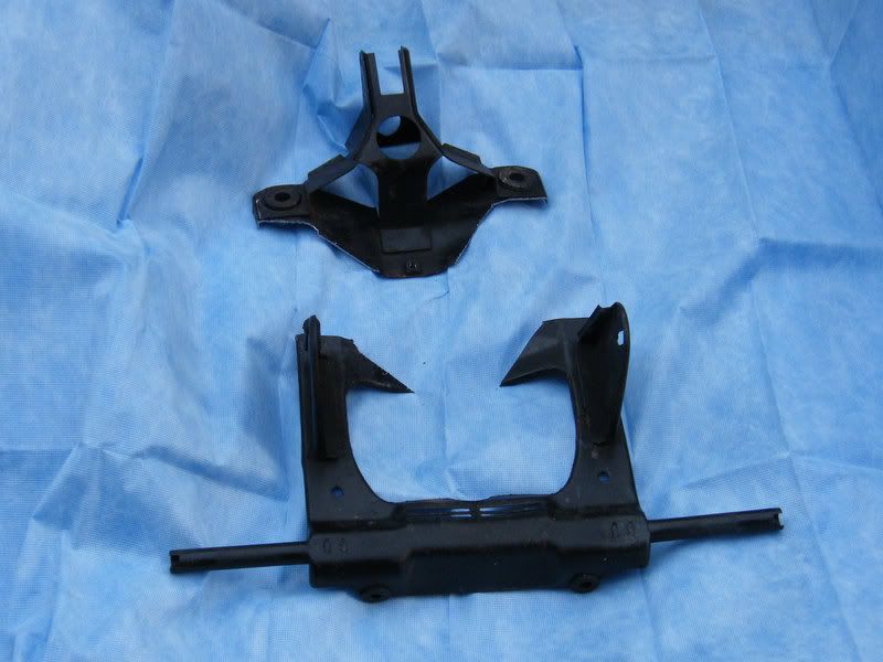

Question for Lars: How is the instrument pod or dashboard mounted on your bike? As far as I can judge there is no room for the original front panel with the RS fairing bracket mounted so either the pod must be mounted in some other way or I have to bring my hacksaw to the original front panel, which pains me a little.
greetings from a freezing and wet north
larstorders
Re: r100rs fairing
« Reply #26 on: December 03, 2008, 03:55:49 PM »
Now you're asking trolle.
Hold on just for a bit while I grab some photos for you.
The R65 instruments have to be elevated moved back toward the yokes and tilted back to fit them in. I'm afraid.
larstorders
Re: r100rs fairing
« Reply #27 on: December 03, 2008, 05:48:09 PM »
I've put a set of pics I took and expanations, while fixing up the instrument mounting bracket here
http://www.flickr.com/photos/larstorders/sets/
   Choose a set. Click on thumbnails at right, then click on '' + all sizes''  tag at top centre of pic for a full size (albeit low res) image. Click back button, click on next thumbnail at right.
Please feel free to ask if I've missed out some details.
TROLLE, What bars are you fitting to yours?
I used standard RS bars and 25mm risers to provide clearance for the front brakes master cylinder from the top yoke.
I'm wondering if you have a 1982 onwards twin disc model like mine, as master cyinders may differ between models.
The R65 instruments are originally mounted much further forward and 'flatter' than those on an R100, for instance. The bracket I made is very sturdy and vibration free, but not ideal from an aesthetic or mechanical view, so only temporary. I am working on a posh mounting utilising stanchion clamps, which should be quite nice, but won't be finished for a few weeks.
I can provide measurements of the temporary mounting I made, if you like Trolle.
In the finest Fed Dibnah tradition, though, my  plans for the final 'posh' mounting are just on the back of an old envelope and penciled on a tasty looking lump of 5083   ;D  ;D .
How did you get on with the brake hoses by the way?
ebay is a good source for steel and aluminium in small quantities.
And yes butchery of the headlamp/instrument mounting plate was a part of my modification :'(
I cut it back even further than this.
« Last Edit: December 03, 2008, 05:54:19 PM by larstorders »

« Reply #28 on: December 03, 2008, 09:55:19 PM »
This is the factory instrument mount for the "police" models:
Thank you very much, just what I needed. I've already printed your pictures to use them as blueprints.
I have an RS bar with clamps, and I intend to use the lower part of the clamps as risers - they have just the right height. And yes the wh8la2 is a October 83 production with the square reservoir.
Please, please send me the measurements as I intend to produce it in stainless steel.
Fed Dibnah?  5083?  Please excuse a humble foreigner  having had the bad luck to be born at the continent, for which I am blaming my parents   >:(
I've just bought new ss-braided hoses from Motobins which I  hope to combine with the old RS-set from Ebay  and the parts from my original set. That is if it is possible to take the original set apart.
That hurt! I bet  [smiley=thud.gif]
