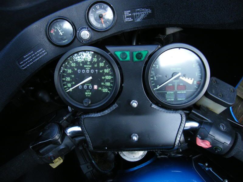

Here's my latest instrument setup.
My previous setup was exactly as I described earlier in the thread fabricated from 1.5 mm steel, I had no problems with instrument vibration. ( I could not figure out a way to use a modification of the original instrument to yoke mountings because of brake lines etc).
 As you can see I have now discarded the BMW rubber surround, because I felt it was taking up too much space within the cockpit (and pushing up against the brake fluid reservoir). The exposed instrument cases are now painted satin black and look ok from the side view. Note the speedo is brand new and has a different case to the original looking very much like the rev counter. It also has kph and mph, very helpful.
I'll be extending the safety edging all round that central plate as soon as I get some more of the stuff. I have a little BMW roundel that will cover one of those domed fixing nuts and maybe I'll come across something to shield the instrument cases. That central plate provides very good stability to the instruments. Yes the voltmeter does stick a bit, but it does work. I wired up the fairing instruments lighting and the fairing driving light via a seperate switch so I can kill them and save my amperes when I'm using the heated jacket.

Sorry, forgot to mention. Underneath that central plate, the instrument mounting bracket is very similar to my original design (insulated from vibes by rubber pads), it just positions the clocks in a slightly better position. The central plate between the instruments is mounted on rubber spacers and seems to keep the show vibration free and makes it very much easier to get at instruments, remove bars etc.

Thank you for the detailed description.

Sorry I forgot to write that your dashboard looks really nice, Lars
