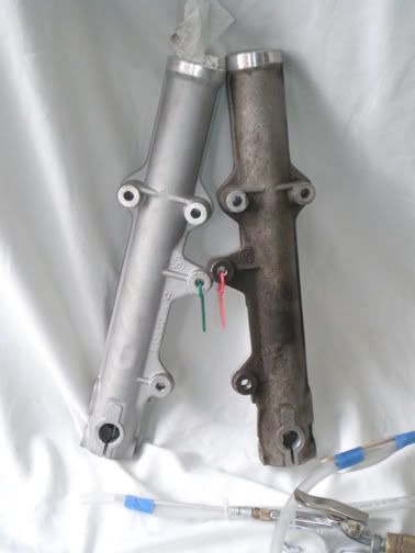

3) The "standard" single-disc R65 does not have provisions for mounting a brake caliper on the right-hand fork lower.
Monte,
Do your R65's not have the caliper mounting lugs on the right hand fork leg ?
Mine does and I've always thought they all did as I've seen it highlighted as a distinguishing feature in several period road tests.

As far as I know all single disc R65s up to the end of the twin shock model have caliper mounts on both fork legs. I am willing to be corrected on this and would like to see a photo of a pre 1985 fork leg w/o mounts.

...Guessing this is a NA export thing...
Correction: Not only did I already have photographic proof but I stumbled out to the shop and "discovered" brake caliper lugs had mysteriously grown on the right-side fork lowers. I even had my head inches away today as I was checking air pressures.
   The pic is from the soda blast of the '83's fork lowers. Green zip indicates starboard lower, red is port. Zips are even attached to the lugs, ya dummy...

Both my North American delivery R65s -81 and 83- do not have caliper mounting lugs on the right-side fork lower.
Guessing this is a NA export thing as both questions are from "outta state".

I think that for at least some years of production, the second front disk brake was a dealer-option, and some bikes came through the NA dealer chain with right fork lower mounting bosses to facilitate dealer installation - otherwise they'd have a very expensive swap out process to do on a new bike, which would be highly frowned upon.   But it is likely that this wasn't a global thing, either.
