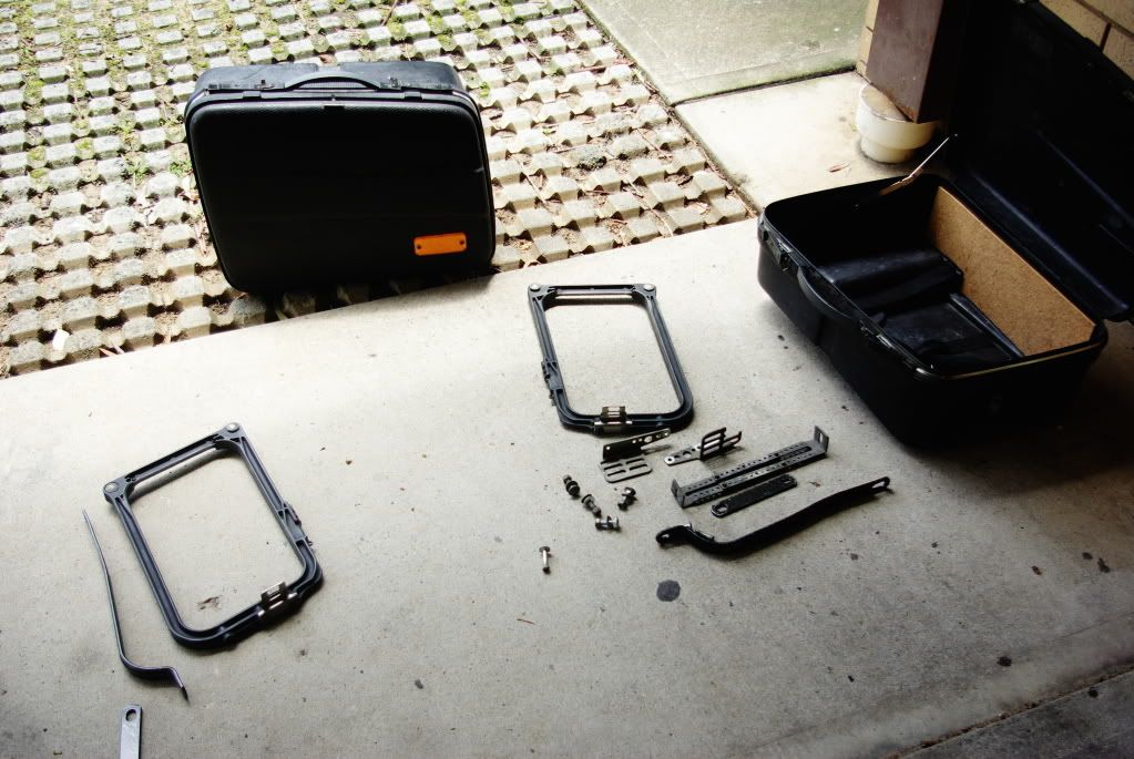

Hi all. I'm looking for som advise (instructions) on how to fit these Krauser panniers. They came with the bike but the previous owner didn't fit them so he doesn't know.
Can anyone assist?
Thanks
It's an R65 LS

Hmm, those frames look different from other Krauser frames that I've seen before... I think someone else will have to help you, but basically, the metal tabs on the rectangular frames goes at the back, and the latch at the rear or the panniers clips onto the tab.   I would assume that the long metal bars with the curved/bend ends attach somewhere along the lower part of the rectangular frames to the bolt on the bike frame just ahead of the passenger footpeg.  The other bits must attach the rectangular frames at some offset from the subframe rails along the lower edge of the seat in some fashion..   Sorry - this is very generalized..

You might have to spread that picture around the internet a little bit.  I am at a loss.  I think it would take someone that has experience with these mounts to be able to help you.
Boxerworks, advrider and BMWMOA (probably have to be a member to post, there).
Also, the German site http://kleineboxer.de/forum/ , which is all in German, but many members speak English, if you can fight your way through the registration process!
Good luck.  I recommend you play around with them, keeping your mind open and your imagination engaged.
This just in - not much, but it MAY give you a start.  It is possible that these mounts won't even fit a BMW 'R' model...
Scroll down about 1/3rd: http://w6rec.com/duane/bmw/bags/krauser/index.htm

I should be able to nut something out. I certainly can't see that anything there is meant for this bike though. Seems to be a lot of "bodgie" stuff.

OK, I got into it this evening armed only with the imagination suggested by Rob. Most parts don't appear to have any resemblance to anything that would affix the Krausers to the Bike. Anyway, I've got some ideas; there's a metal loop under the pod that looks like it's part of the original machine that will be very handy for the insertion of threaded rod with a rubber grommit to support the upper section of a frame. I still need to support the lower sectiion but reluctant to drill the plastic frames where they weren't designed to be drilled. Some clamping might be needed there.
Anyway, another problem appeared with the bottom hinge on one of the panniers snapped. It looks like the hinge was probably polypropylene which doesn't fatigue with use that's eventually fatigued with use. A metal piano hinge fitted internally should fix that.
I'll see how I go & report.  8-)

Yes, that metal loop at the extreme end of the subframe is meant for mounting pannier mounts and/or a luggage rack.
My pannier mounts mount there, at the shock mounts, and near the passenger footpegs.
Did you see the pictures on Duane's page for the Universal A-mounts?
Lots of similar parts, there.
http://w6rec.com/duane/bmw/bags/krauser/krauser_universal.jpg

You have the dreaded "universal" mounting kit that came with aftermarket generic Krausers.  If you have good metal fabrication skills they can be adapted but the best bet is to watch flea-bay, ibmwr.org, etc., for an R65 specific set of mounts.

I had an original set which i stupidly sold, those frames similar but the mounts were definitely different and there was a cast rear rack.
The bottom mounts had a snug curve around the Shocks.
