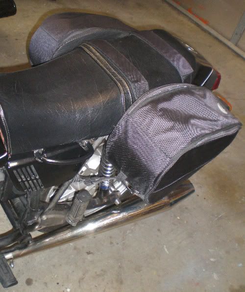

...I've purchased a set of RJays saddle bags that cost $89 that slip under the seat and joined by velcro.
These soft bags are by FasTrax. Very easy to fit and remove. Not waterproof but they do have a zippered compartment for a pull-over "rain suit" for each bag.
I like 'em as they can be yanked off when I want to go out and play, then fitted to carry items for the work commute.
Specs mentioned the Velcro straps going over the fender. Well, that looked as saggy as my old grandmother. Over the seat, the stout Velcro straps keep them at their best fit. Adjustable straps at the front secure the bags to a frame member while a similar strap snugs around the rear fender / frame loop. Quick disconnects for the side and rear straps speed the detach chore and remain on the bike.
I've had them long enough to say they wear well and travel nicely. No luggage frames either.
