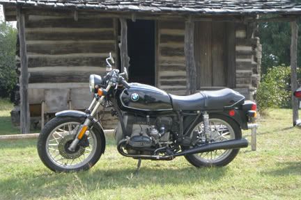

Early structure in downtown Forestburg, Texas. My R65.

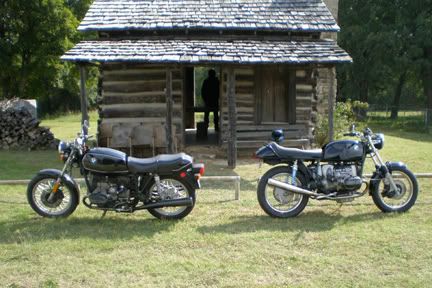

My R65 and buddy's R100S... an immaculate bike.
