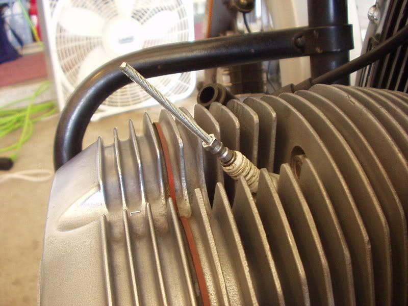

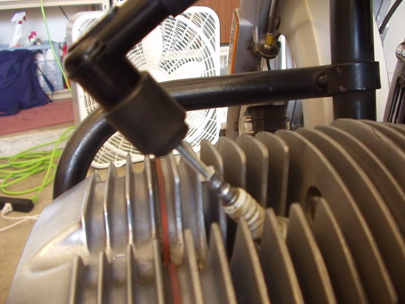

As for the adapter, I had to run over to ACE to make it. Cost was $1.30. I had a couple of old spark plug screw caps, what I bought was a couple of 4 X 70 screws that are 60mm long. Thats metric, don't buy an SAE #4 screw it will be too small. Who knew that spark plug tops were metric? I also went all out and blew 13 cents on a couple of jam nuts, I'd get wing nuts net time to make installation on the plugs less fiddly. Screwed em into the caps part way, tightened the jam nut against the cap, clipped off the screw head and viola

I made a pair. As for earthing myself, If I've read correctly adjustment is made while both sides are running. only a brief grounding of each side is done for comparison. You don't actually adjust & ground at the same time.
