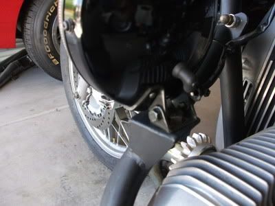

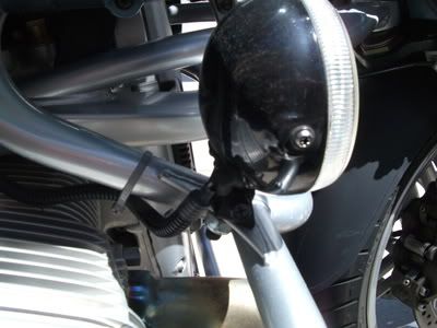

I've got a set of PIAA 510's on the oilhead and a set of PIAA 40's on the '81 R65 .
I'll get some pictures this evening .
I would suggest staying with the smaller lights, the PIAA 40's (6.25 inch diameter) needed extra gussets on the bracket, to keep them from vibrating .

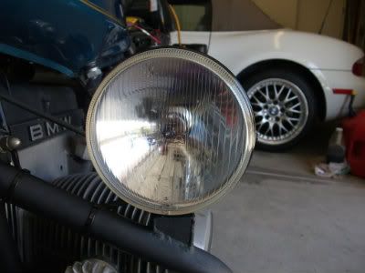

Here's a few pictures of the PIAA 40's on the '81 R65 .
Here's the smaller PIAA 510 on the oilhead .

Re: crash bar lights
« Reply #6 on: June 07, 2012, 05:56:03 PM »
I got 'em cheap on eBay, $50US including shipping .
I had to take the PIAA H3 bulbs out and replace them with regular halogen bulbs from NAPA, they were too much in night conditions .
