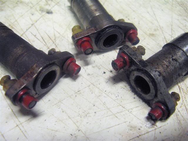

Thinking of going in to add a second hall sensor. Wondering tho where to get those little red plastic bush parts that ride on the pins / weights for the advance unit. Not a good description but if you've been in there you may know what I'm referring to.

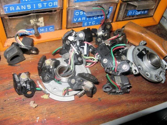

airhead
Re: Tickover Problems when hot '84 (no points)
« Reply #13 on: May 23, 2008, 02:29:25 AM »
You mean these things? Never seen them before!!!
These are actually my spares as I've found some in the past split or worn through, they simply pull off. However, why do you want them fitting a spare sensor? All you need is very accurate measuring to get the spare unit 180degrees opposite the original, and another lead and plug to the outside. Too fidly for me, I just keep a spare beancan, but never had to swap it so far.
BTW, I have a sale at the moment, a whole heap of pre-loved short lead triggers.......only half price!! LOL
Bill..............................;-)
« Reply #14 on: May 23, 2008, 05:14:04 PM »
Why yes Bill those do resemble my remarks! I just figured that while I was at it I might as well refresh the whole deal with springs and such. Quite the collection you have there! I'd read about adding another trigger 180° as a backup. Your awesome collection has made it apparent to me that this might be a good Idea! Still want some new little red thingies tho!
Rich
BTW Ive seen where some German sites call this the "Milk Can" [Milch kann]
