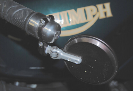

I came with (2) chrome mirrors not in great shape.  Bar end mirrors could work if the other ones I mentioned don't provide good visibility - making a lane change into a car or truck would kinda wreck my day!
Wondering how I'd fit a bar end mirror on the throttle side w/out moving when I move the throttle.  My previous bike, the F650 had stock bar ends on the handlebar but not mirrors - they were counterweights.
I've read about CRG's and Napoleons.
Monte - you've got some on your Triumph, right?  If so what brand are they?
I'm after good visibility and a good alternative to stock BMW mirrors.
Re: New 0ld Airhead - R60/5
« Reply #14 on: November 24, 2012, 09:28:34 AM »
Not really true bar end mirrors.
The aluminum anti-vibe plugs on the handlebars were removed and machined to accept these small, adjustable, clamp-on mirrors.
I still utilize the larger fairing-attached mirrors for the "big picture" but the smaller mirrors are great for lane checking; looking for close-in bandits. Don't recall the brand.
