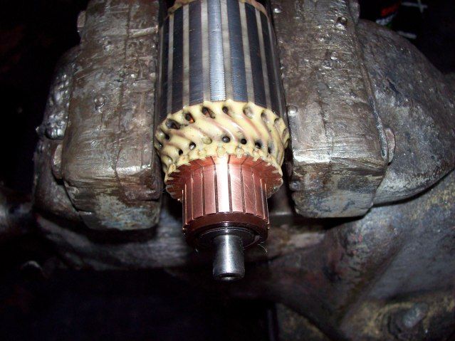

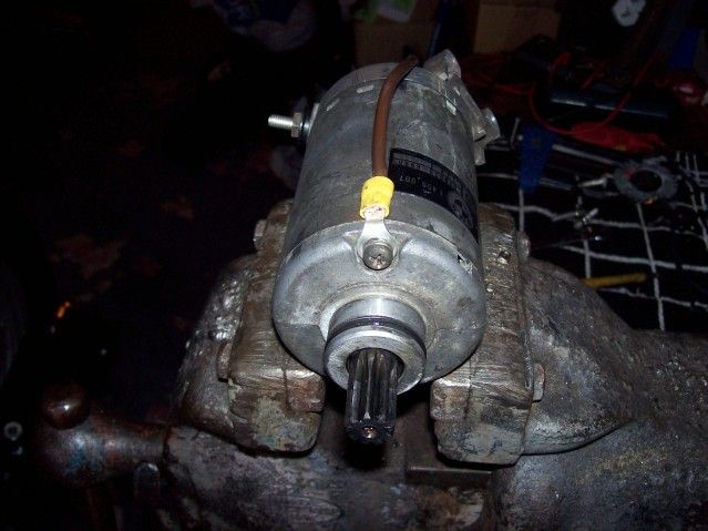

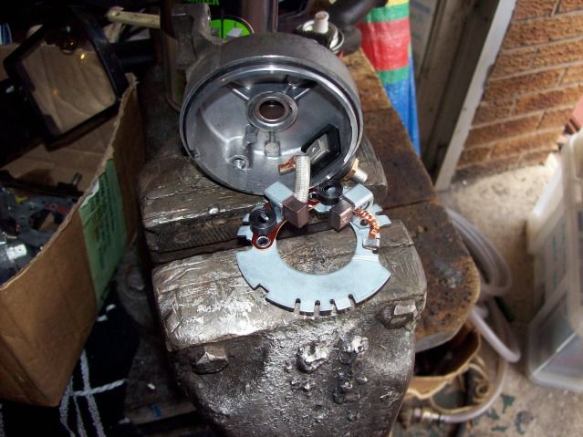

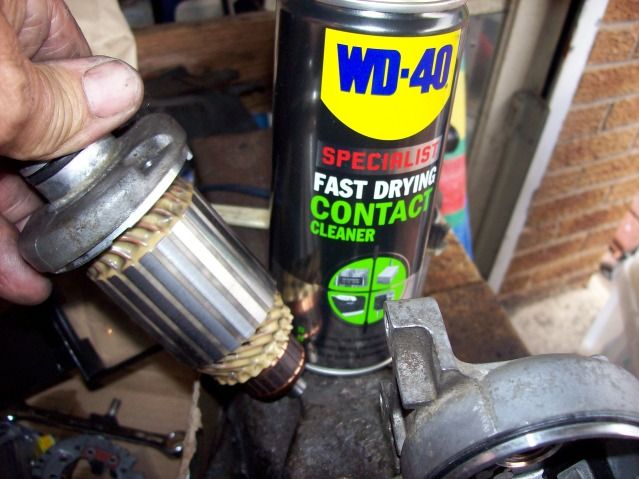

Oh joy.... sorted, all Loads lead to Rome (starter motor) the Load shed Relay earths/grounds back through the starter motor.
Having stripped cleaned and replaced the brushes carefully cleaning the commutator and cleaning the segment gaps. We have lift off no sign of gremlins slight mod though, when i megga tested the earth through the starter body there was significant resistance through the body to the anchor points so i have put an additional earth wire to the casing bolts......on the road again tra la la.
