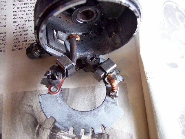

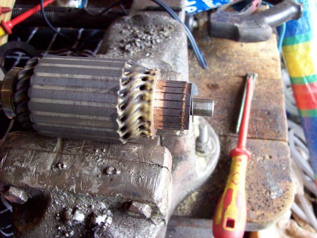

Progress is slow but as i suspected i have 2 separate problems, i stripped the starter motor where one of the brushes is shot, while tinkering with the battery connected the headlights briefly came on when i was repositioning the connectors on the main wiring loom.

One brush is 1/4" shorter than the other
