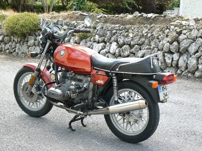

Purist's may not approve but to replace my badly corroded  brown seat, I went with a new /7 black seat, it meant losing the cowl but I find the grab rail is handy with bungy cord for carrying stuff. The seat is nice and firm and quite comfortable.
I still have the old seat and cowl and will look into restoring.

It looks real good, did you have to alter the hinge mounting points and seat lock pin ?

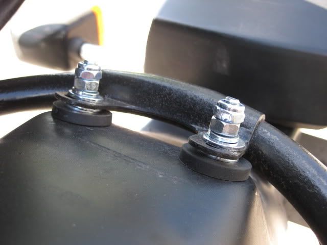

No, though I struggled with it for a while, and thought the lock pin was the problem, but actually it was the rear fender, I had to lower the fender slightly with washers ( steel and rubber, see below).
I also had to trim a piece off the rim of the little box that sits over the battery, then it worked fine.
Though when the seat first arrived (http://www.bmwbayer.de/Seat-with-rail-/7-models-cross-stamping-cover.html), I was really scratching my head, it turned out they had sent the wrong seat ( a /6), but once that was established they sorted it out pretty quickly.
PS:The white BMW roundel does not come on the seat, I did that myself using a stencil sourced on ebay.
