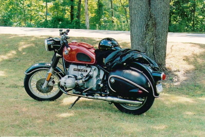

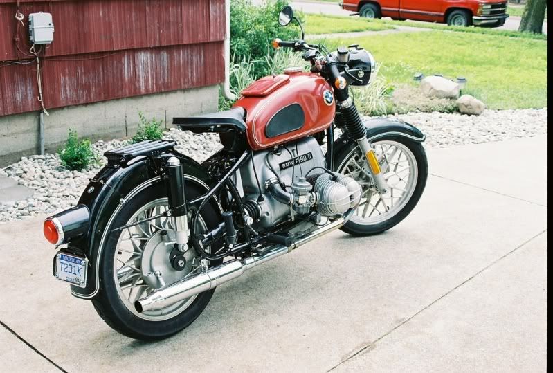

Here's a mix of an R65, R90, and older /2 frame. Pretty cool conversion!  [smiley=thumbsup.gif]
Re: R90 man is converted to R65; Gimmee some tips! PLS
« Reply #7 on: March 27, 2009, 11:30:25 AM »
Nice looking bike.
Did he manage to keep the top yoke (triple tree)?
One of the best bits that differentiate an R65 from the rest of the heard.
Moo!
« Last Edit: March 27, 2009, 11:31:10 AM by steve_hawkins »
