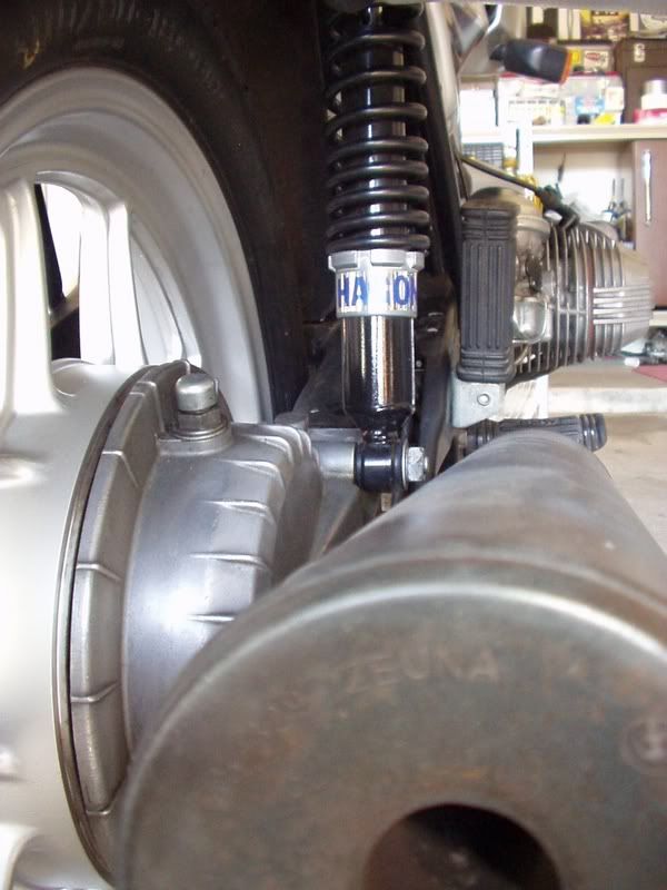

Hello,  My bike is a 81 r65 but it seems to have the black LS pipes on it.  It seems they have gotten louder lately  (maybe my imagination)  and I would like to quiet them back down. I know exhausts need repacking from time to time but how do you actually go about doing this.  I also had the end cap off one pipe recently and saw no sign of any packing, should there be some or do these exhausts rely solely on the baffles to quiet them down?

I have the LS pipes on my bike and I can tell you that they are a bit louder than the standard pipes. Of course mine are very old and that may be a part of it. One thing you said has me scratching my head. The mufflers on my bike have the ends welded on, there is no way to remove the "end cap". This makes me think that you may have an after market [estraz] set of silencers. Can you post a good photo somewhere of your exhaust?

Hey Ben howzabout a close-up of those mystery mufflers [silencers]?

Was gone for a few days. I think your right that I have something aftermarket.  Mine are black but looking nothing like yours rich.  I can drill a couple rivets out and open mine up.  then the baffles can be pulled dout.  Here is a pic that shows some of it, dont have a better one right now.  http://i193.photobucket.com/albums/z283/bpw40/P1010308.jpg
