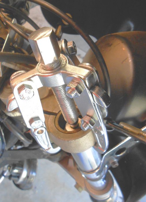

Pretty Wife rolled outta the garage/shop at 0600 hours this Wednesday morning. Heading outta Texas for three whole days to visit her momma. Took her sister with her. What to do, what to do...
Been wanting to disassemble the front forks on the '81 R65 for a basic inspection and service. Kept putting it off 'cause of that danged Upper Fork Tube Plug. That's a 3-handed job if there ever was one. I usually use an 8mm Allen socket and a hefty impact driver to push the plug down and hold it by leaning on it. Uncomfortable and there's always the fear of that big snap ring flying off to Dog knows where.
Found a solution. Used a small, 3-jaw puller. 2-jaw would be better but I had to dance with the girl I brung. Photo is pretty much self-explanatory. Much easier to push down on that snap ring, get it semi-vertical and fish it out with needlenose pliers.
Now back out to do the other fork leg.

Re: Upper Fork Tube Plug easy-out
« Reply #1 on: September 24, 2015, 04:44:18 AM »
Great idea, thanks for the tip.
« Reply #2 on: September 24, 2015, 09:50:41 AM »
Boy Monte I remember the contortions to do that job with strong Derek leaning on whatever we had contrived to push down on that top bit. Derek is not overly happy to help me either as he hates the bikes. So this solution will be a big help. Thanks!

Those bearing pullers have more uses than many give them credit for!

I have a method that enables me to do this single handed but it's probably not as easy as Monte's.
I insert an Allen key in the fill screw and then press down on the top of the plug against the main spring pressure with a large screw driver. Once the plug has been depressed enough I rotate the Allen key so that it jams underneath the handler bar holding the plug in the depressed position. The Allen key has a rubber sleeve on it to prevent it from slipping out from under the bar.  I then have both hands free to remove the C clip.  Works like a charm on low Euro bars but might not on US bars.
Just shows to go ya there's more'n one way to skin a cat. Good idea, Barry.  [smiley=beer.gif]
