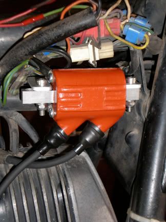

The Bosch OEM black n' gray ignition coil, more often referred to as the Crack-O-Matic, has a well deserved bad reputation.
If you wish, remove the tank and inspect the coil. It may be better to remover the "Cracker" to better check for hairline cracks, often on the end of the coil but in rare instances, along the length. Note the barely visible circular-pattern cracks in the end. This off my '81 R65.
The Dyna "Brown" coil... sure looks orange to me... from Rick Jones at Motorrad Elektrik is a first class unit. No mods. Bolts right up. Adding the Dyna coil is a great opportunity to replace plug wires and install NGK soark plud caps.
That nasty, scabbed on wiring was from a PO's fairing install. Long since removed.
BTW, That run-kill switch is notorious for failing. Itty bitty spring and a tiny ball bearing work together to keep the engine dead... at the most inopportune times. Parts are NLA. I never use that Gubmint-mandated switch on any of my three Airheads.
