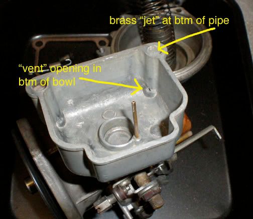

Been sitting for awhile, right? Drop the float bowls and confirm the small "jet" passages that feed the enrichener circuit fuel reservoirs are not clogged with fuel varnish.
If you have compression and spark, that's two of the three biggies. Also confirm the idle air adjust screws are set to your LS's specs.

However, my money is on clogged float bowl jets.

Thanks all. Just needed a bit of a cleaning as suggested. I'm on the road!
