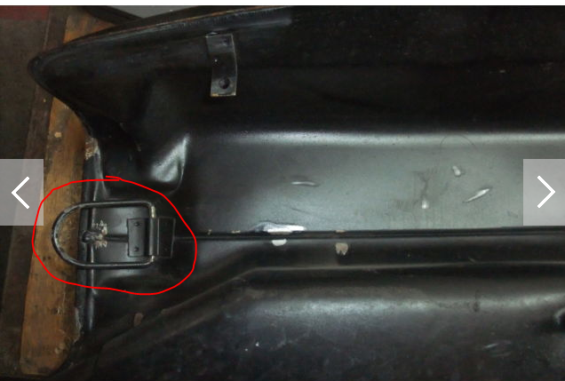

So the old tank on this 83 has not been helpful in me figuring out how to mount the new one...
Front rubber piece is on frame, I got that much.
Front of tank seats in there.
Rear of tank has small hoop that goes down and hooks on the frame... see the attached photo...
My buddies '78 R100 has bolts that come down from tank and extension of frame where they seat top and they bolts that screw in.
I feel like there is something else missing, any thoughts?

The only thing you are missing, is what looks like piece of rubber tubing that goes on the metal bale at the back of the tank .
That piece of tubing is what keeps the metal bale tensioned so it doesn't come off of the end of the frame tube .
Re: '83 R65 - Tank mounting question(s)
« Reply #2 on: May 01, 2014, 04:09:40 PM »
I don't see the two L shaped pieces of rubber that should be glued to the inner edges of the tank to buffer it from the frame tubes. Items 2 & 3 in the diagram. They go right at the back of the tank and not at the front as shown.
You can spring that bale clip open to thread on the rubber tube that Bob mentioned. That is in the diagram although I'd say it looks too short as shown.
No bolts of any description with our tanks. It's held very securely with that bale clip and yet can be removed in seconds.

So the tab that has a threaded hole is for what exactly? :-?

I've heard that the tab with the threaded hole was there for mounting the tank on a post during painting at the factory.
While we're on the bottom of the tank, you should know that the metal tube sticking out of the bottom is the end of the drain hole that is under the gas cap.  It's a good idea to put some fuel line over it and route that to a safe place.  If gasoline goes down that hole it can land on hot exhaust pipes.
I think Luca has it correct. We had a thread about this some time back and you could even see the paint line on mine which seemed to confirm what it was for.
