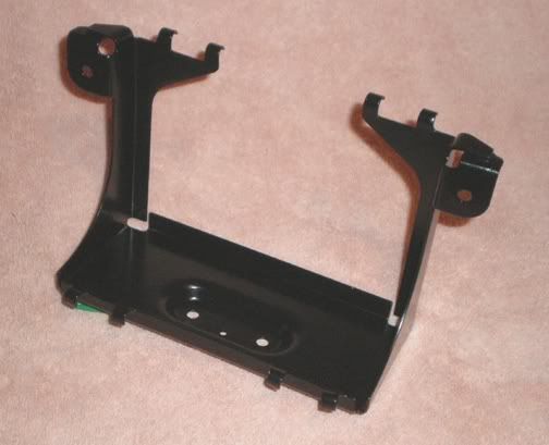

This is the battery holder for the R65. Check a parts fiche for the necessary nuts, bolts, washers and rubber grommets for a proper install. The R65 uses two wide rubber straps to secure the battery in the tray... or bungee cords if the OEM rubbers bring tears to your eyes.
