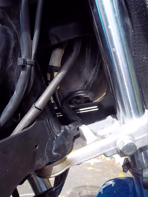

can either of you guys take a picture of the clutch cable routing? i have mine at least what i think was the way i took it off, but i feel that there is either too much slack or maybe im not routing it well. I have it zip-tied to the frame so it won't hit the exhaust
Im running mine along the frame, then up through the front of the forks behind the gauge mount to the clutch, and well there be cable stretch because i have the cable not even tightened and had to pull the clutch back a bit to get the cable on.
the more pictures the better, i tried doing a search with no pictures :(

Offline Air4Life
  • Posts: 206
Re: Was on my way to work, when this happened...
« Reply #14 on: May 01, 2013, 07:36:10 AM »
I will go out later today and see if I can capture more.  But I think this image (included originally on other thread) shows it passing between the head lamp and the bucket:
