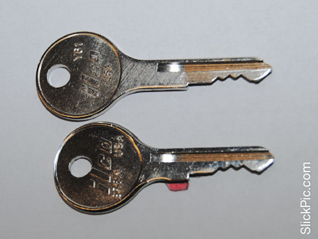

In a prior post, I had provided a source for late 60's to 1994 Airhead key blanks. Eric Johnson at http://Motokeys.com is a good source for the plated brass Ilco Y61 blanks.
Bob Roller mentioned the Ilco SR61N as another Airhead key blank.
This morning, I rode the 1978 R100S to a full service locksmith shop and had the man cut my Ilco Y61 blank to match the R100S's tatty old key. The new key worked, as Lucky Lou would say, "Sweet as a nut".
The gentleman showed me the Ilco SR61N as Bob mentioned. It was a little shorter in overall length which might keep my new key from getting bent. The R100S has the ignition switch on the left-side headlight ear attach point.
"Cut me one of those, too", says I. Plugged it in but it'd didn't turn on the ignition switch. Huh?
Check the photo. The Ilco Y61 is the key on top. Slightly longer than the Ilco SR61N shown below.
The problem was quickly noticed by the locksmith. The SR61N was not going all the way into the ignition switch. Note the red area in the photo: This 'ledge' -on the key blank- had to be cut away to permit the full entry of the key and correct alignment of key to tumblers.
If you plan on using the SR61N as a replacement key, remember this information and use it if your new key does not work in your particular ignition switch. As always, YMMV.
