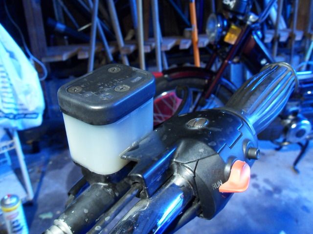

It's in very good condition with low miles and changed the fluid every three years or so.   But it's developed "the drip".   There's always a dribble hanging off of the bottom and it gets on the paint and irritates me.
I'd like to remove the piston and plunger and oring, clean everything up spic and span,  carefully hone the barrel, and replace the plunger and oring for about 10 to 15 dollars in parts.   Possible?   Are these parts sold separately anywhere?
Anyone know of suitable off-the-shelf replacment plungers that will fit and oring, perhaps from a honda or kaw that uses the same size piston and plunger, has these parts in stock, probably fresher rubber, at quite likely 10 to 15 dollars or less?
Thanks
 Brad W

I have honed my cylinder twice, I used 1200 grit wet and dry paper wrapped around a timber dowell. Dont hone longitudinally, use rotational honing only and it should be okay as long as you don't have serious pitting.
Be sure to clean out the tiny fluid return hole while you have the reservoir off the cylinder.

If the master cylinder bore isn't pitted too badly, it can be cleaned up easily, I used a hardwood dowel, cut a notch in one end and used some scotchbrite type material to clean up the bore .
The master cylinder can be difficult to get removed from the handlebar 'perch' casting, there usually is corrosion in there .

My master cylinder is really badly pitted and leaks like there no tomorrow. I tried Bruce's suggestion of using really fine grit sandpaper(I used 2000 grit) wrapped around a dowel(or a screwdriver in my case). I was sanding it wet for that extra smooth finish. It took me a around half an hour of rotating the thing inside the cylinder since I got carried away while watching a movie. When I re-installed the thing back on, it got fixed and never leaked. That was two and a half months ago. Until now, it's still not leaking. Mind you, that was a badly corroded master cylinder. It still had those pits on it but apparently, when properly bled, I think the piston never goes far enough t contact those bumps.

Sorry.   I agree that lives depend on these things, but I'm also a confident enough mechanic that I trust the limits of my skills.   Otherwise I'd defer just about everything that my life depends upon, including most drivetrain repairs (they can lock up too at highway speeds), brake repairs,  wheel removal and installation,  handlebar removal installation, steering bearing removal, installation and adjustment, etc, etc.  I feel very comfortable in my judgement as to where I can get by 'cheaply', or in the case of a 100 dollar "rebuild" for a couple of master cylinder parts which I was hoping someone had sourced more cheaply.
This is a Magura 12 or 13 mm brake master cylinder.  Difficult to imagine that internal part is BMW proprietary sized.    If BMW does not supply the rubber replacement plunger as a separate item then I imagine another manufacturer must.  And it's likely to have been sitting on the shelf for less time.
It's been 20 years since I rebuilt this thing, replacing at that time the entire piston/plunger/rubber itself instead of just the lipped rubber. Is that lipped rubber piston seal a removeable item?
All that can possibly leak in this system is that rubber plunger ring and the oring on the plastic cup.   With a good careful cleaning and honing this needn't be more than a 10 to 15 dollar cost in fresh parts.
