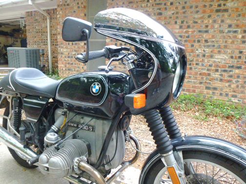

Well, here is my experience with the EMGO fairing... we finally installed last friday with a couple of surprises:
1. The master cylinder actually ended up clear from the fairing, so no problem there...
2. The brackets that came with it fitted from the box and no customizing was necessary (I read this was not the case)
3. There is a small (about 1/2") space between the headlight and the hole in the fairing, we will use a gasket from a R65LS to cover that.
We managed to sit the upper part of the fairing (without the windshield) on the back of the instruments housing, so it doesn´t move anywhere... it actually helped a lot regarding wind vs vibration...
Its a little bit noisy but with the helmet on, you can´t tell the difference...
Here are the pics, hope it helps!!
Take care!!

Very neat job, much neater than my attempt at the indicator cut outs!
I would advise to add some lock nuts on the brackets, I even ended up adding lock nuts to all of the screen to headlight fairing bolt points as I lost one completely as it worked free after a bit of riding. Be very careful tightening these, don't over tighten! I did and caused a hairline crack, though luckily its not spread and is not very noticeable.
Also if you feel its vibing a bit too much, I found adding a couple of cable ties underneath to attache to the headlight mount helped.

Well done fbenach,
I've been looking at these fairings and wondering how they would look.
Thanks for the pics. I ordered one today based on your results.
A few questions if you don't mind answering them.
The more detail the better.
1. How did you determine where to drill the holes for the indicator stems? I have an idea but you seem to have got it pretty damn close.
2. Would you do it any differently?
3. How/what did you use to cut the holes out so neatly?
4. I have read somewhere that ABS plastic cracks/chips easily when cut or sanded. Did you find this problem?
Thanks and great job.   [smiley=bmw_smiley.gif]

Based on my experiences fitting an EMGO fairing on my 1981 R65 plus mounting an Airtech fairing on Bengt Phorqs R90/6...
With the EMGO product, I noticed some paint marks on the interior but these proved to be only 'general area" assists. Removing the turn signals and running a trimmed to length small dowel through the headlight bracket tube can get you close... after you've mocked up the fairing's position using tape, sticks, another pair of hands, whatever it takes.
Conventional drill bits will not bore the larger, tidy holes for the turn signal stalks. Purchase a Forstner bit of the hole diameter you desire. Big box home improvement stores are your tool source. ALWAYS back up the substrate before drilling. Position a block of wood where the drill will break through. Secure the block and drill the hole through the fairing and into the wood.
I cut ABS material using a Dremel tool mounting a reinforced cut-off wheel. Get close to the final trim line but do not try to get a finished cut using the Dremel. The plastic will overheat so go slowly and let the material cool frequently. A belt sander plus a hard sanding block with a 150 grit paper will get you where you want to be. Large dowels or small tin cans are also helpful sanding blocks.
The raw edges can be wet sanded up through 1000 grit and will provide quite a polished edge.

Just in case, here is my experience on the one in the pics:
1. We did not do any special maesurement to determine the position of the holes... You will see that once you have the fairing in your hands, you will be able to tell pretty close where they go. Although, we discover that the fairing is not perfectly symmetric when we fitted it and realize there was a slight difference on the indicator steem position on both sides... so, one ended up a little bit closer to the egde of the hole than the other, but you can hardly notice it when you see it.
2. What would I do the next time? I will try to drill the holes a little bit smaller. I might want to use a homemade rubber gasket for the separation that is between the headlight and the fairing main hole. The R65LS gasket we used is not thick enough to cover it, so that´s a pending task.
3-4.We used a 1.5" (I think) metal hole driller, and actually, we didin´t need to use any sand paper to finish it, the cut went out clean from the begining... we used a 4 speed driller, being 4 the fastest, we used speed 3. There was a little bit of heating... now that I read what Monte says, next time I will be more careful about the heating issue.
About driving, I agree with Steve, there is a little bit more noise and you feel a little bit more the crossed winds (nothing to worry about). The body resistance against wind was not noticeable, but I discovered, when riding above the 100kph, if you lower your head, it does get a lot better. But there ir a bonus, as far as I live in the tropics, where it rains a lot and heavy, the fairing kinda forms an air protection barrier, whch has made more confortable riding under water.
Besides that, I suggest replacing the bolts that attaches the windshield to the fairing, as long as they are not stainless steel, and got a little bit of corrosion pretty fast.
The bottom line is, the fairing is mostly a "looks" accesory more than  "functional", which was my main reason to install it.
