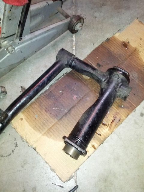

Sorry to keep bugging you guys but Clymers manual isn't helping out that much...
I have removed the swing arm removed by my home made shaved down shaft socket and now I can't remove the drive shaft. Do I need a special tool to remove it? The Clymers book have a 6 sided bolt but on mine it's a round bolt.

Do you have the drive shaft and swing arm removed from the bike ?

I already have the swing arm removed.
I need the drive shaft removed so that way I can send everything out to be powder coated

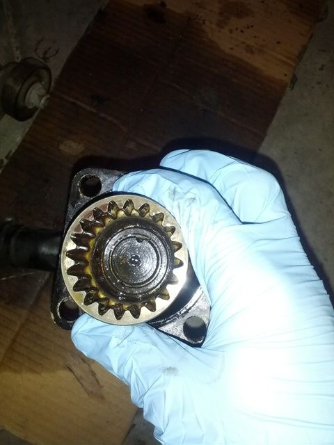

You need a tool or fixture that looks like a McPherson strut compressor, it compresses the spring on the driveshaft and exposes a circlip that is just visible in your second picture, once that circlip is removed, the drive shaft comes apart and you can remove it from the swing arm housing .
Here's a blowup diagram of the drive shaft, hope it clears up the disassembly a bit .
