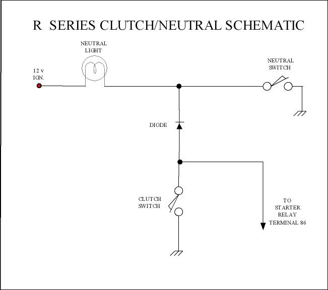

I would need to look at the schematic but the diode isolates the neutral switch from the clutch switch so they won't interact with each other.  I think that if the diode was to short then when you pulled in the clutch it would activate the neutral light, but it's been a long time since I looked at that circuit.  I suppose if the diode was to open then maybe either the neutral OR clutch switch might not function.  I don't know  if an oilhead uses the same circuit or not...

Here's the schematic, so will give an indication of the actual circuit, unlike a wiring diagram which would have to be model specific.

Looking at the diagram supplied by Bill then it would appear to me that if the diode were to open then the neutral light would work normally but the bike would not start when in neutral, unless the clutch was pulled in - the clutch switch would function properly.  If the diode was shorted then the neutral light would illuminate when the clutch was pulled in, but the circuit would otherwise operate "normally".
Now that Bill mentioned it, I think I remember the isolation diode only having one connection per end...

That diode is located inside the starter relay I believe beginning with the '81 model year. I replaced one about 24 years ago, on my original starter relay. Mine failed with continuity in both 'directions', and every time the clutch was pulled the neutral light would come on.

Exactly how it works Justin.
As far as the diodes location, like Bob said, from '81 the diode is incorporated in the starter relay. For the R65, from '78 - '81 it's in the wiring loom just under the relay and looks like a small tube. Before that, the other models (/6 & /7) had it mounted behind the connection/fuse board inside the headlight shell.
