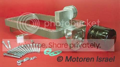

Does anyone have one of these? Looks like a pretty good cure for the $2000 "O" ring. It was listed at 219.00 Euro's which sounds awfully cheap for all that machining...........is this "snake oil" or is it really $900 +shipping?   I want one !!!!

Good lord! Talk about an oil filter in harm's way...
Bob Roller daily rides his R65 through the streets of hell; excuse me, make that Phoenix, Arizona, and has done so for decades. I'd enjoy hearing his comments on the "item". [smiley=thumbdown.gif]

It appears to be a "sump extender" as well as an oil -filter relocation device.   So, your ground clearance would be reduced, as well as placing the oil filter right up front where the front wheel will throw things at it all day.
Might be OK if you rode on tarmac roads all the time, but I wouldn't want it on a G/S, that's for sure!
The Motoren Israel guys do come up with some ingenious/good stuff, but personally, I don't favor this one.

I'm just trying to figure out how it works .
It looks like the right hand round portion with an o-ring is meant to fit  into something on the engine block .
I've only had the oil pan off of my bike once and I don't remember seeing anything in there that would work with this part .
I'm thinking you may need to machine the engine block to make this work .
I think I'd pass on it, too many unanswered questions and quite pricey !!!!!

You will have to remove the oil filter housing to install this.

Yes I agree the filter tube will definitely have to be removed and then the device presumably seals in its place with guess what - an O ring.
One thing not mentioned is that you effectively get an oil cooler with the filter stuck out in the breeze.
As the very last thing I need is cooler oil I think I'd pass too.

After seeing where the oil pan ends and the distance from there to the front of the timing cover, I think there's plenty of room.
As for using off road, I'm thinking it would be easy enough to create a shield to protect it. Maybe even a bash plate that extends far enough.
Another idea would be to mock up an insulated shield to encapsulate the filter. That would keep it warmer and protect it as well.
And just think of the increased crankcase volume, besides the bit of extra oil carried in the filter.
The filter change really isn't a big deal once you've got it all sorted out, but if this set-up can take cheaper filters, it could save ten to fifteen bucks every oil change. That's something to consider.

Looking at this a bit closer .
If the filter was at the front, wouldn't the oil filter canister area be on the opposite side of where the round part with the o-ring on it, would fit into it ?
Even if you rotated the part 180 degrees, it still wouldn't mate up to anything in the oil pan area .
It's not making much sense to me !!!!!
