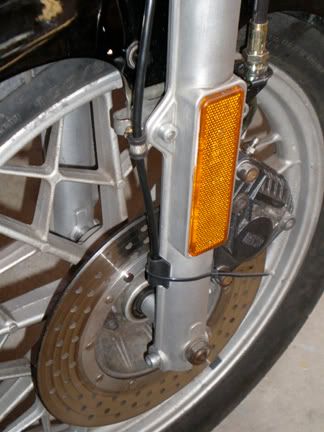

A rare earth magnet attaches to the brake disc holder and triggers a sensor each time the magnet passes by. You will calculate the front tire's exact diameter and program this info into the Vapor. That data provides the speedometer readout.

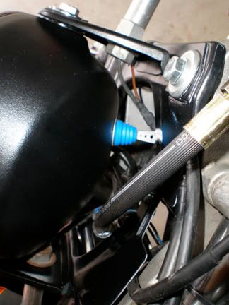

Hey Monte, will you please add a photo to this thread, showing your ignition switch?  A part number would be cool, too.

Really simple deal. Ed. I snagged a SPST 30A weatherproof (sorta) toggle switch, with male spade connectors, from FLAPS. I used a Unibit to do a workman-like job of putting a hole through the sheet metal headlight shell.
   Of course, there's no longer an ignition lock. Your call on that issue. When I bought the '81. the ignition lock was from a Briggs n' Stratton riding lawn mower. Too nice, it was. ::) You may be able to fit the OEM switch in the shell, maybe.
Gave up the parking light feature but, to me, that little light is just a fast way to accidentally run down my battery.
Should you have questions regarding the wiring, lemme know.
