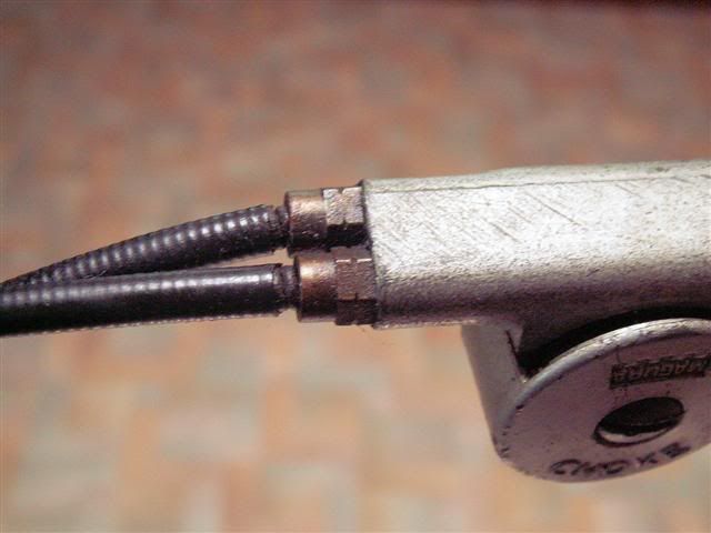

when i rescued my poor 65 it was missing the air box and choke control. i found what i needed on ebay, ordered a set of cables from my local dealer (nick's bmw of green bay). i had installed them, when to choke the carbs it works like it is supposed to, when i go to turn the choke off the cable doesnt move the housing moves? what am i doing wrong? i tried tighten up the adjuster knobs but it still does it because there isnt enough to get the cable housing tight in the adjusters. do i need longer cable housings or shorter housings? shorter cables?

Do you have the little brass hex fittings fitted to the lever as in the pic?
It is common for people to remove them with the cables, though they are actually a part of the lever housing. The outer sheath threads into them to locate and lock the cables to stop exactly what you are experiencing.

mine dont have threads on the inside? i have them on the choke lever and they are quite a bit bigger that my cables? could they be from something else?
