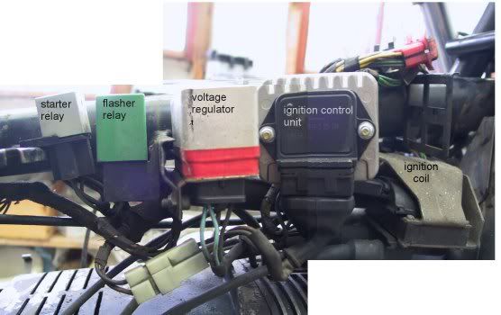

Hi Gang
I'm thinking my R65LS is Haunted.  My BMW buddy, a retired engineer and I spent several hours today trying to troubleshoot.  All we get is a "click" from the headlight relay (at least that's what I think it is).  No lights, no instrument lights, no horn, no starter.  Just a click when we turn the switch.  That's it.
The Clymer book has a wiring diagram but we're wondering if any of you have one that might show more detail?   I've attached a picture of the different relays & boxes that are electrical.  If you can help me identify what does what, that should be helpful.
I'm open to suggestions :)

This pic has been posted several times before by others, but I had problems finding the threads, so here goes:
There is also a headlight relay as one of the relays on that rack - I can't recall if it is usually the inside or outside one, but given the state of your bike, I wouldn't count on it being in a specific location.
Attached is a color image wiring diagram from a Haynes manual that may help.  Both the Clymer manual and the Haynes manual have errors/omissions, but perhaps between the two you can figure out your relays and wires.

I have a picture of a R65  that was shared by this group- maybe Mike Valenti - maybe from grumpy guy or ???
Anyway, if you look back at the picture I posted on first post today (scroll up) there is another electrical box on the picture I have that is not on my bike.  It is in the open space behind the tandem relays and in front of the tourquoise blue electrical box (may be for aftermarket hazard flashers).

Ken - your pic looks like the others -  there should be a starter relay, a headlight relay, a flasher relay under there to the "left" of the metal gray box with red tape, which is the voltage regulator.   Some bikes may have a horn relay also installed (particularly if your bike has dual horns or horns other than the simple, single round beep-beep horn that came standard.   There is also the possibility of a larger box that looks sorta like a relay but which is a buzzer/turn signal reminder.
USe the colors of the wires that go to the relay connections to help you determine which is what.  Also, use the colored wiring schematic included above to see what wires in the ignition/light switch get connected together based on the position of the key in the switch - it's all there for example, in "park" position the red and the gray wires are connected in the switch, got it?
