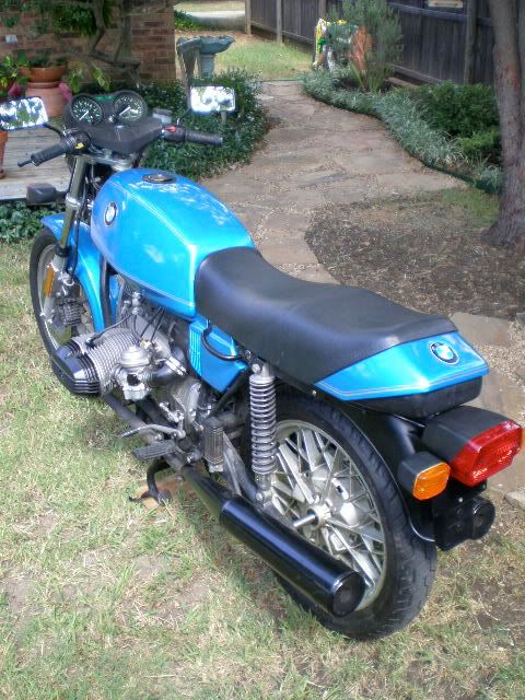

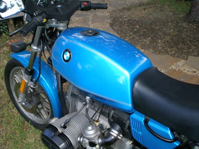

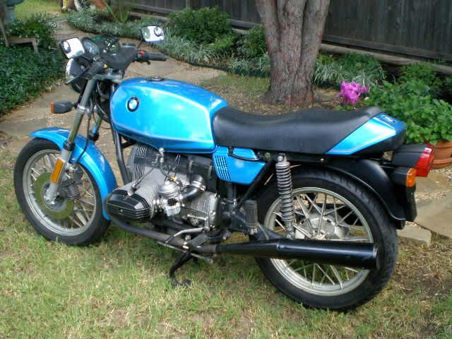

Here's some snaps of the 1983 R65 "needs nothing" Mexico Bike:
Finally got around to adding some silver vinyl pinstripes in the OEM positions on the tank and tail piece. The fuel tank looks so much better! The BMW 501 blue is gorgeous but really needed the visually slimming effect of the stripes.

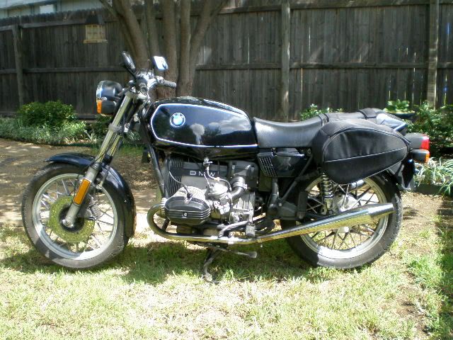

And here's the 1981 with its new-to-me EPCO stainless steel mufflers and soft bags. There's a matching magnetic tank bag that will go along on next month's Three Twisted Sisters ride in the Texas Hill Country.
It's going to be a great summer [smiley=bmw_smiley.gif]   Monte
