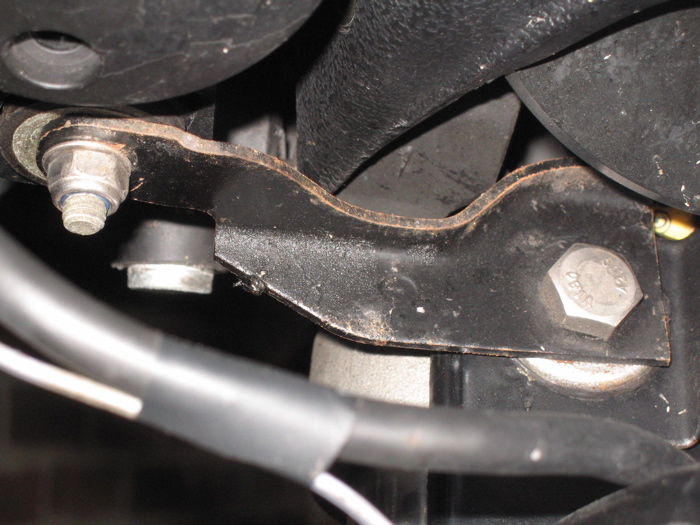

Hi Rob, I only have a little digital camera (Canon Ixus 750) but here goes. In the top left of the picture what you see is the underside of the clock pod, the one on the right-hand side of the bike. The fitting has nothing to do with the headlight ears. Hope this is some use!
Dizerens5
Re: Voltmeter and clock pod mounting brackets attachme
« Reply #6 on: December 08, 2009, 03:16:42 AM »
PS the top right part, looks like a sharp edged piece of pie, is the underside of the tacho. It isn't really sharp edged, it's just the light of the flash shining off it!
[size=14]So, does the tab that sticks out perpendicular to the bracket go under the lip that protrudes forward at he top of the headlight/turn signal/instrument panel? If not, where does it go?
Doc
[/size]
« Reply #9 on: December 13, 2009, 10:57:43 PM »
From what I can see, the welded-on perpendicular tab extends rearward, contacting the edge of the breastplate, preventing it from rotating.
In the photo from above, you can see a circular dimple.  That is the tack weld for the tab.
#10 is the left, and #11 is for the right.
This picture is looking from the front toward the rear.
« Last Edit: December 13, 2009, 11:02:00 PM by Rob_Valdez_79_R65 »

Gosh! What a lot of trouble this little pod bracket seems to be causing! Here' a photo of the back side, maybe this will help. The bright little round object top left, above the fork leg, is the brake fluid  drain plug at the handlebar lever.
Good luck!

Another look at the photo leads me to ask: what's the welded-on tab for anyway? It doesn't seem to have any particular purpose. Or does it?
I would venture to say, your right and left are swapped.
I think the tab is to prevent the bracket from rotating if the bolt loosened, in which case, it needs to be below the bracket, not above.
This change would also alter the height of the instruments to a slight degree, I think.
« Last Edit: December 18, 2009, 06:31:11 PM by Rob_Valdez_79_R65 »
Dizerens5
« Reply #13 on: December 20, 2009, 05:00:39 AM »
I expect you are right Rob, though I find it difficult to visualise how it would look upside down and other way round! and surely don't intend to take it apart to try! However the pod/clock/bracket assembly is not heavy and is fixed under a pretty big hex head, so I doubt it would ever move, tab or no tab. The pods on my R65 seem to have been there a long while. Incidentally while the clock is very good the BMW voltmeter well fulfills its reputation for being inaccurate!
