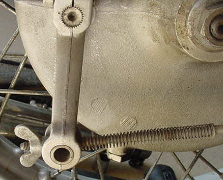

I just rebuilt the front Brembos on my '82 LS and the "mounting hardware kit" consisted of two long pins, a short pin with centered groove, and a flat anti-rattle spring.  The parts shown in your pic look similar, but longer, so I am wondering if they might be for the larger Brembo calipers such as those used on the R80, R100, etc.?
Your rear shoes can get oily by either a leaky rear seal (where the wheel splines up) or the O-rings that seal the brake actuating rod are shot.  Where this actuating shaft sticks through the final drive actually goes through where the gear lube is and the shaft has a couple of machined grooves with O-rings.  I think Sue has had to replace these...

Do the new pins you have fit? I see the long one on the left is almost identical except shorter on the top end. Move it down a quarter inch and all the grooves line up as well as locking ring. But is it now actually too short or is the end of the pin just recessed a little further than you had before?
The short pin is longer but does it still fit in the caliper?
Justin is right about looking at your rear oil seal and the brake rod which on the 82 , should have three O-rings I think, plus a thin felt pad on the outside of the brake rod where the actuating arm attaches.

I will look again at the rear hub area 500 miles in, I have bought three o-rings, but where is the oil seal located?
Looking at the final drive with wheel off and brake shoes removed. (I know you had just put them on.  ;) ). There is a cover with 8 or so bolts around it. The wheel drive splines comes out of this. Unbolt the nuts. At around 2pm and 8pm you will see two blank 6mm threaded holes. Use a couple of spare bolts in these holes, tighten evenly and it will force the cover off the final drive base. You might have a gasket under here, but both my R65 and R80 didn't , just gasket sealer. Once the cover is off, use something to knock out the oil seal and tap a new one in. Fiddly because it is a large oil seal, but doable. Try and use a large flat surface and tap on that.
Note when buying the oil seal, there is a different one for mono and dual shock bikes.
If your bike has a gasket, put another gasket on, if not I would suggest just gasket cement.

Let us address the three small o-rings for a moment.
I have never replaced mine, but I am sure they need it.
Does one have to remove the inner cover in order to get the brake actuating shaft out?
I do know that before you remove the brake lever from the splined shaft on the outside of the final drive, you should mark their relative location so you can put them back in the same orientation.
http://www.w6rec.com/duane/bmw/rear_brake/index.htm

My brake shaft only had slots for 2 o-rings.  I guess there is an upgrade (maybe it's the LS version) that will take 4.  So I have two extra now.
You should probably mark the relationship between the shaft and the final drive housing, as well as the lever, just to be sure.  Though there's only two ways (I think) the shaft would even work.
You don't have to remove the inner cover, just the tire and brake shoes.  I can't remember how I forced the shaft out but I know I didn't break anything for once.   :D
Is yours leaking oil?  I find my rear brake works better without the oil, though I don't think it will last as long.
