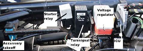

« Reply #3 on: March 06, 2009, 05:54:07 PM »
Give the flasher and connections a look under the fuel tank.

« Reply #4 on: March 06, 2009, 05:57:17 PM »
What year is your bike?  MrRiden's photo is for the '81-'84 models.
Re: my directionsl lights are not flashing
« Reply #5 on: March 06, 2009, 06:00:24 PM »
Oops, good catch Rob and it's really not my photo but one I got form this forum!

« Reply #7 on: March 07, 2009, 03:04:20 AM »
Thanks for the picture Mr. Riden! Not-so-fast-ed is right I should put the year first! Its a 1979 R65 and I live in London, UK. Thanks

« Reply #10 on: March 07, 2009, 09:45:25 PM »
On the '78-'80 models, the turn signal flasher is behind the right side cover, next to the fuses.
