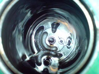

[size=12]Sunbeem got us a nice picture of where this is all taking place.  Not the easiest place to work...
That's it, at ~3:00[/size]

What in there on the right at about 3o'clock?  I thought pressure relief was up in front over the camchain?  So there are two pressure relief points?  I s this the same on our 1980 - 1979 bikes???
Dagnabbit! Alls I gots is a digital watch!  :'(
Seriously, Thanks Rob for the caution. I have never seen this discussed nor paid attention to to the relief spring. I'll be checking on this for sure next oil change. Perhaps Justin could whip up a tool to remove the retainer? I'll take one.
