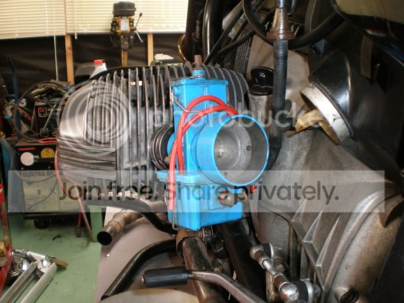

Here's my carb upgrade - 34mm Blue Magnums....well, ones a 34, the other is a 30 bored out.  I used them on a Yamaha XS1, and are supposed to go on another XS650, but thought I'd see how flat slides went on the R65.  They went well enough, but never got them fully sorted.  I'll need air filters, the ones I had on them have gone on the TLR200 and Stornello 160.

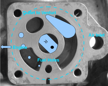

Looking at Mike's list reminded me that your carb 64/32/203 will have the early version of the enricher disk. I'm assuming that's what 831 vs 861 means.  Anyway if you look at the disk and compare it to this pic you will probably find, if it's not already been done, that the smallest of the fuel holes has not been drilled.  If so I can recommend either replacing the disks with the later part or carrying out the mods on the attached service bulletin.  The need for this mods is perhaps one justifiable criticism of the early  flat tops.
If your enrichers work well then the mods may already have been done.
