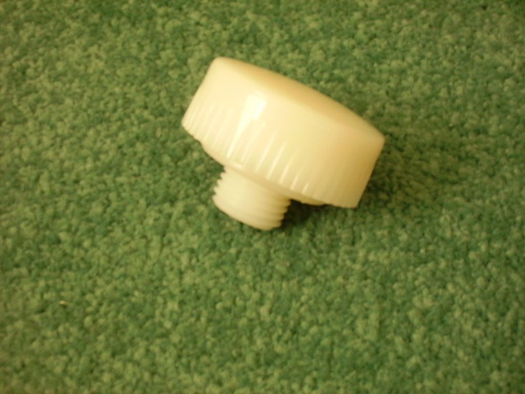

Couldnt wait for mail order components. Yes its part number 24 on the diagram. So made my own from the nylon head for a 'soft nylon hammer' . this material is spongier than the original hard nylon ring in the dampers and must be at least as tough as the original fibre ring it will replace (I hope). Maybe they'll be ok. Apologies for the HUGE size of these pics.

monte, how would Delrin work?
