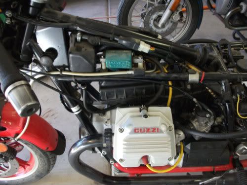

  • Posts: 9140
Re: Started On The '87 Guzzi Today
« Reply #14 on: October 26, 2012, 09:31:45 PM »
Got the front fork oil changed, needed the maintenance manual for this, as I would have never figured it out on my own !!!!!!! ;D ;D ;D ;D
Bengt Phorqs asked for some pictures, here they are !!

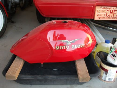

Fuel tank being de-gunked .

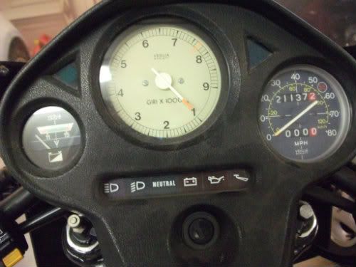

Instrument cluster . Notice how the tachometer is the focalpoint, the speedometer is there if you really wanted to look at it . ;D ;D ;D ;D ;D

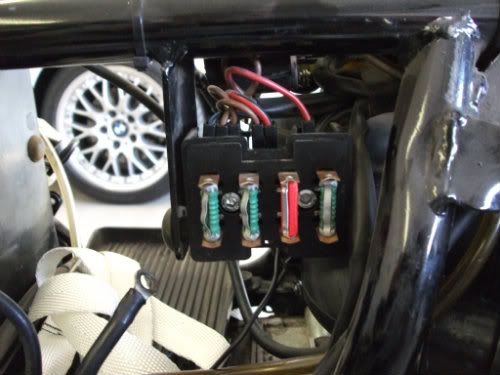

Same crappy fuses that the R65 has .

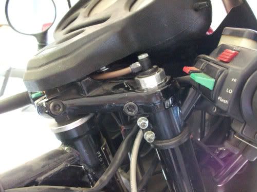

Left fork tube top .

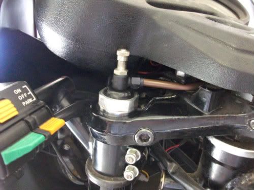

Right fork top, there's an interconnect tube between the fork tops, for adding air to the front forks .

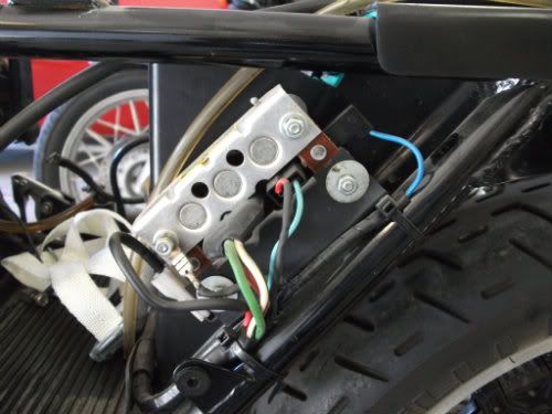

Diode board .

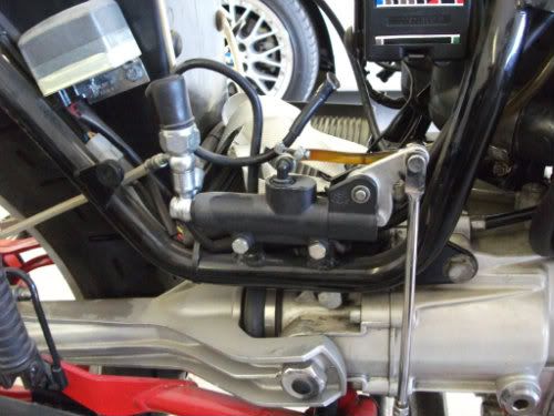

Linked front and rear brake master cylinder, voltage regulator in the upper left hand corner .

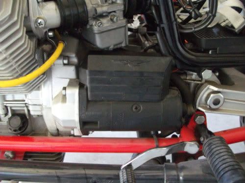

Same Bosch starter as the airhead BMW's, output gear that engages the flywheel, has one or two fewer teeth .

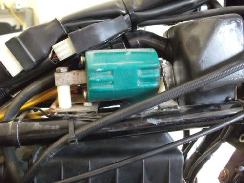

One of the Dyna 'green' ignition coils, previous owner added a Dyna electronic ignition system, to replace the points type system .

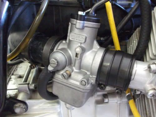

Right Dell Orto carb, the fuel inlet has a last chance flat filter disc, under the inlet fitting .
Left cylinder and left side of bike .

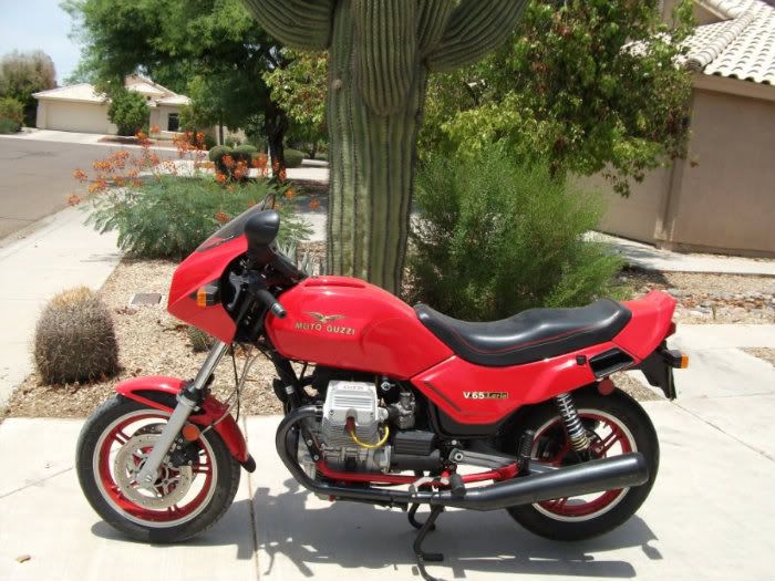

Here's a picture from about a year ago, fully assembled .
