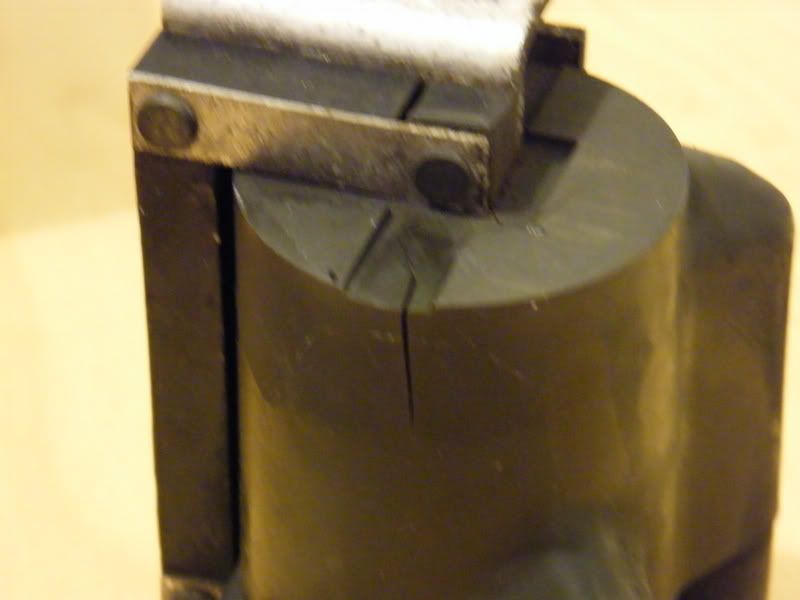

Where do you spot cracks on stock coils? I guess they must be of the hairline variety?

« Reply #14 on: October 16, 2008, 05:42:33 PM »
This cracked coil is from a 1982 R65. Hall effect ignition trigger, and I believe, typical. Way bigger than hairline, yet the coil still works good, though, too risky to put it back on a bike.
However, sometimes, I guess, cracks are just internal in the windings.
