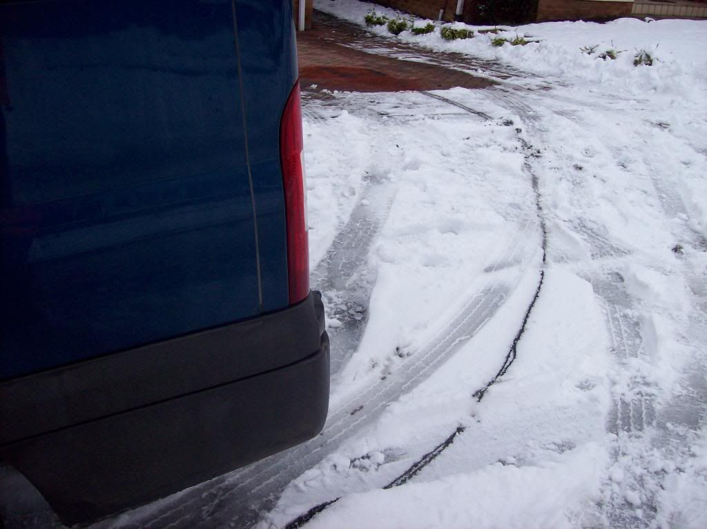

I know the famous $2000 "O"  Ring on our beloved Airheads but i have just had a close encounter of the expensive kind.

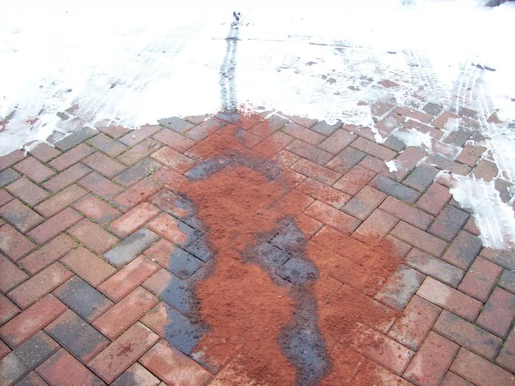

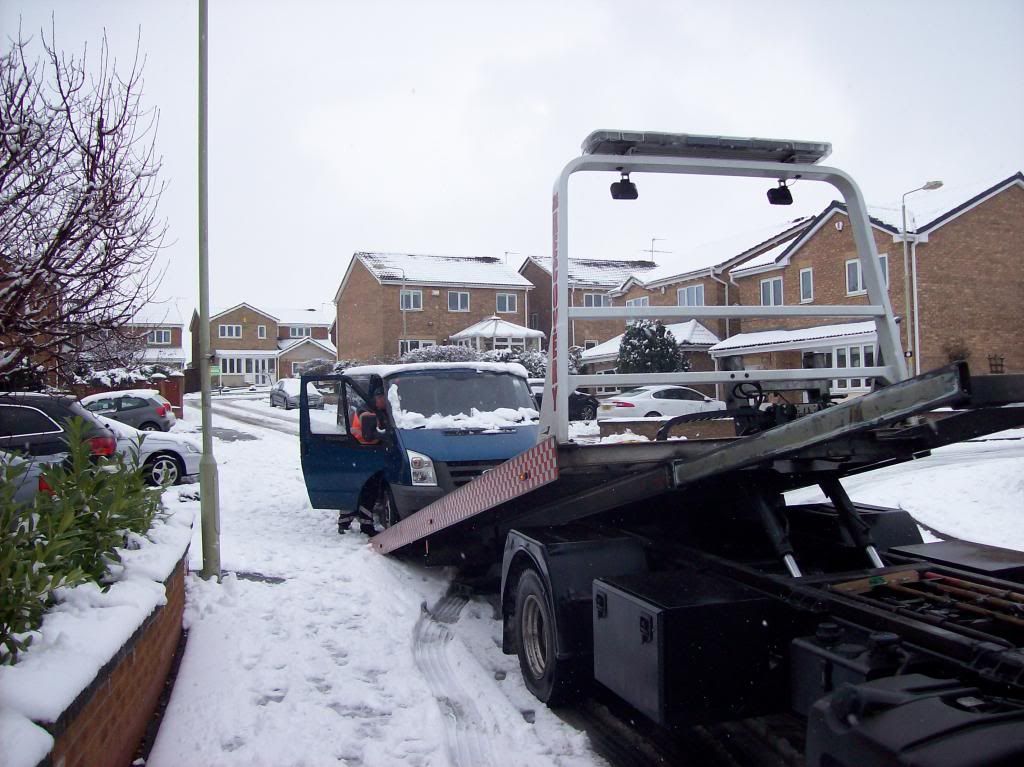

I had my van serviced 4 weeks ago and as i was returning home the oil light started flickering then stayed on, only 1/4 mile from home so i thought it would be ok to get back (stupid is....). I stopped checked the oil .... nothing on the stick ????? put 5 litres in and still nothing on the stick ?? so i though i would start the engine to see what was going on (stupid is....) oil was pi**ing out from under the engine.... call recovery and back to the garage.

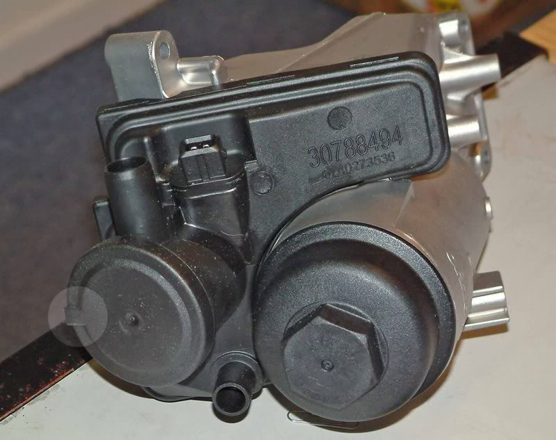

I turns out the Ford in their wisdom have dispensed with metal cartridge oil filters on the post 07 engines and fitted paper filters in a plastic housing.....
The filter housing had split, i dont know if they had over tightened it when it was serviced or as it is located at the front of the engine it is possible to have been struck by something, any way it turns out i was lucky no major damage to the engine  just a bill for £150 on top of the £400 i spent  a few weeks back and a clean up job on the drive, it could have been alot worse, next if the oil light comes on...............stop.

I didn't know they had been around that long. My 24 year old Merc has a metal spin on filter. I'm curious about these plastic filter housings, they surely must have a seal of some sort, maybe a large O ring. If that's the case they shouldn't need tightening any more than a spin on filters does.
It has a large "O" ring about 5mm thick which sits in a groove just below the thread.More worrying the oil pump casing appears to be plastic as well.

So only the the filter cap is plastic. I guess it doesn't need much torque to seal against the O ring.
