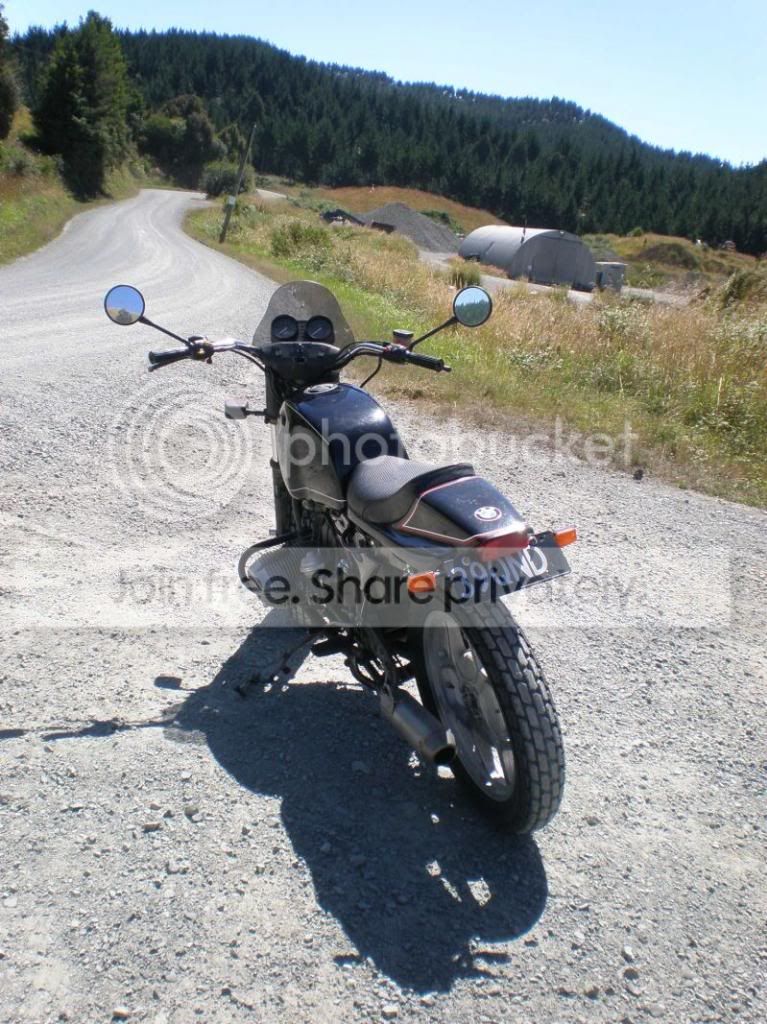

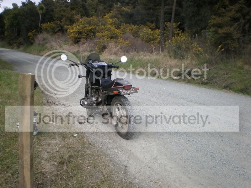

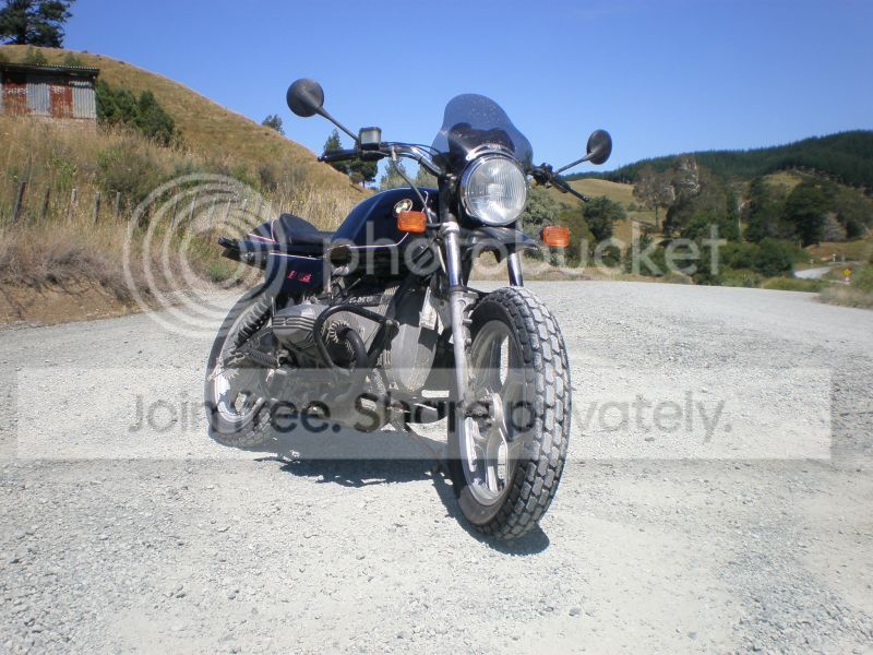

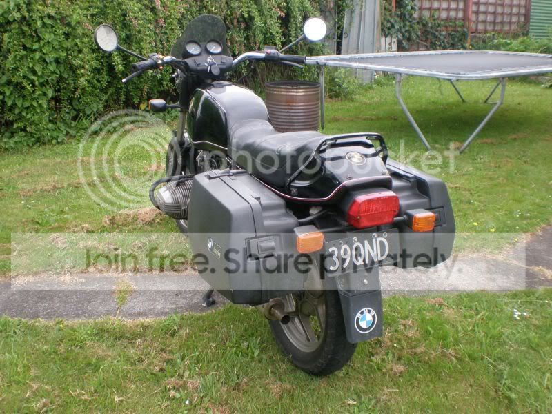

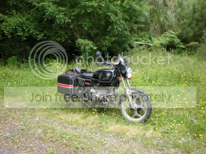

I have set my Mono up as a streettracker - but I have changed nothing, I often convert it back to a completely stock bike for 2 up or touring with panniers. 30 minutes to change seat, wheels and front guard....sometimes I fit the stock exhaust, but normally use a 2 into 1 . I also have panniers for the streettracker. The bars are Slideways from Omar.
The Mono has 2.50 x 18 rims front and rear - so I use the same tyres both ends.

Nice mono !  What kind of screen is that ?  I'd like to fit one to my blue 1986 R65

Smallest Givi I could find.
