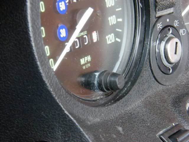

Due to old age, I suppose, the rubber nipple covering my trip meter reset button has perished totally. Now the rain gets in, Aaarrrgh! Anyone ideas for a substitute please.

A perfect replacement for the trip counter reset button sits only a few inches away from the instruments....
The RUBBER DUST COVER FOR THE BRAKE CALIPER BLEED NIPPLE IS ABSOLUTELY PERFECT FOR THE JOB.
It sticks on beautifully with a bit of super glue and looks just right.
I cant believe it's taken so long to spot this.  ::)

The bleed nipple cover I used works perfectly. I highly recommend it  and it's not at all stiff.

OK, which bleeder nipple cover do you have?  Is it a stock BNMW item or an aftermarket one.  I looked at a couple I have laying around and they are quite "thick" and rather inflexible...  Post a pic with it installed!

This is the chap. A standard brembo dust cover. Loads of them at my 'local' Ducati dealership.  ;)
Note, kph stickers, all ready for start of alpine tour and Oktoberfest next week. Yahoooo !!!!

OK, I'm gonna have to find me a couple of those...  Great substitution work!
