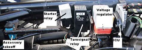

To check the charging system the method I know of is to have the bike running [you'll need to jump it again] and check the voltage once more at the battery terminals. Above idle at oh say 2000rpm you should see 13 volts or above. If its below 13v at running speed the regulator or generator may be faulty but first clean up all your electrical connections at the regulator. There is a simple way to jump the regulator with a short piece of wire but I can't recall which pins get jumped.
How exactly do I do this?  Assuming it is the charging system as Justin indicates, now what?  What's the next move, in baby steps please.

Does "clean up all your electrical connections at the regulator" mean remove them from the terminal and hit them with a brush?   :-/
Should I test the resistance on these wires or is the problem something internal to the regulator?  In which case then what?  Replace? Jump using the unknown method that Mr. Riden suggested?

OK I found it. Remove the Voltage Regulator from its socket. You should see 3 female connection points. If yer really lucky they will even have identifying letters [or look on the regulator itself for corresponding id letters] They will be marked f+, f- and Df. We want the f+ and Df connectors that are directly opposite each other. The wires will be Blue and Blue with a black tracer or even all black. We DO NOT want to use the brown wire. Make up a handy little jumper wire with a male spade connector on each end [you now have a new tool for your on board tool roll] insert the jumper to connect the f+ and DF wires to each other [blue & blue black]  Get 'er started however ya need to and check the voltage at the battery terminals. Got 13-15 volts? Go to your local auto parts store and get a Borg-Warner R-588 or Neihoff WA 709.
A good parts counter person can cross reference against either the Borg-Warner R-588 or the Neihoff WA 709 numbers to find one that werks. I suggest these because they are half or less than the BMW part.
If however you jumper out the regulator and still do not see sufficient charging We're going to take off the front engine cover[ disconnect the battery first!] and begin by checking all the connections [clean / tight / connected] at the diode board. You may also have bad brushes on the alternator [not hard to change but fiddly] or the most expensive, open alternator windings. Lets go for the regulator first 'cuz it's cheap and easy.
