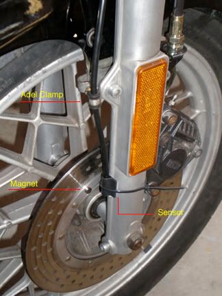

Still in the long drawn out process of calibrating my speedo...so to run in conjunction with it for the moment, I am about to fix a bicycle computer speedo to the front wheel and fork. Anyone ever done this before?

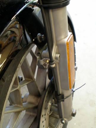

Yes, there have been several in-depth discussion on this, by VA Steve, me, and a few other folks, with pics too. A very popular mod for the older bike set.
They were all in the Technical Discussion area, so a search should turn them up.
Re: Bicycle speedo
« Reply #4 on: August 28, 2008, 06:15:42 PM »
I did a search on "bicycle" and found several threads.
This one had a picture of an installation:
http://suraklyn.com/yabb/YaBB.pl?num=1174912262/2#2

It was me!
Look at http://www.geocities.com/willhutch1959/R65_homepage.html
and all will be revealed!

Very similar to my TrailTech Vapor digital rig. A rare earth magnet epoxied to the brake disc triggers the sensor. Easy programing the instrument head with the tire's diameter. Bike speedo probably cheaper but the Vapor has tons of nice features including a Hobbs meter.

All great stuff! Thanks for the links. I was wondering how to fix the magnet to the wheel, but epoxy seems to be the answer to that one. I have a radio controlled speedo, so no cables to route, but the sensor cannot be more than 60cm from the speedo, so I am thinking of mounting the magnet on the wheel rim, and the sensor on the mudguard on a bracket.
