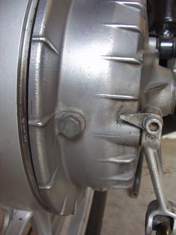

not-so-fast-ed wrote: "On my bike there is a 'MAX' and 'MIN' mark on the drive housing that an indicator points to when the brake is applied.  This is the approximate amount of shoe remaining.  'MIN' means 'Buy new shoes'. "

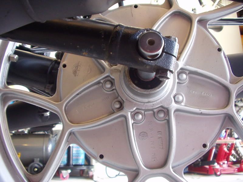

Well now, I just had a look at my LS and it has neither plug nor scale on the drum or hub! I do have the nifty little pointer tho! Go figure.

This is what mine looks like when the Rear Brake is applied.  Of course I just recently put new shoes on so it better indicate "MAX".   ;)
Ed
(Where'd all that dirt & grease come from???)

Ed, I'll have to look for that brake wear indicator.  Like Altritter, I didn't know it existed!
Re: Rear brakes: adjustment or new shoes?
« Reply #14 on: August 24, 2008, 05:51:25 PM »
no plug no scale ??? 82 R65LS
