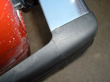

OK, it's not a motorcycle and the nationality is all wrong for the Lavera. But it IS ABS plastic and I did fix it! Man, those stone "pecks" really show up. Ugh!
I maintain and consider myself the caretaker on my elderly VW Cabriolet. The aluminum bumpers have ABS end caps. They are as rare as hen's teeth these days so fixing them is just about the best way to go unless you're willing to pay large dollars on eBay.
Spot the small crack? I stop drilled the stress crack with a 3/32 " bit. Hopefully, that will keep the crack from migrating. Still needed to fix / reinforce the area.
Now comes Ace Hardware's house-brand ABS 5-minute epoxy. I'll spare myself additional embarassment with the story related in the link. Read it and have pity on me  ;)
Backtracking here to my aircraft construction for just a moment. Composite aircraft -fiberglas, E-glass, kevlar, vinylester, carbon fiber, etc- frequently need additional reinforcement at joint lines and corners. Enter a material known as Cotton Flox. Visualize, if you will, a cotton ball that has been sent through the food processor on the puree setting. That's flox.
A one-pound bag of this lightweight stuff takes up a lotta space. When blended with epoxy resins for lamination or epoxy adhesives, the flox becomes a reinforcing matrix of cross-linked fibers. Barney style, it's stronger than your momma's love.
I fixed the Cabriolet fender cap with the Ace ABS adhesive and a bit of cotton flox. A built up area on the backside of the fender cap did the trick. A suitably sized piece of heavyweight fiberglass cloth would work as well. The end cap break is now very solid. Couple links to suppliers who maintain web catalogs.

And this is the stuff. Beemer saddlebags with cracks can be repaired economically. I would suggest not using the material on the exterior surfaces unless absolutely necessary. Wipe off any adhesive squeeze out before the material cures. That should camouflage the area nicely.
