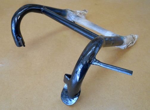

The ground contact points on the centerstand will also wear down to the point that just getting the bike up, over n' onto the stand is a hernia-inducing experience. This stand is off my R100S. Best to inspect both the chassis-to-stand contacts and the stand-to-ground points.
Also, if your R65 has the US Civil War 'mini-ball' as a foot contact, keep an eye out for the later R65 centerstand that has better geometry and an honest foot pad. Saves ruining your boot sole. Added the newer style stand to my '81 R65 and that made a world of difference.
