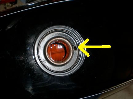

My R65 still has an occasional venting problem. The issue manifests itself when the fuel stops flowing to the carbs!
Note the photo and the vent location. I have run a double-length pipe cleaner into the pipe and did not feel any obstruction but I don't know where the vent ends. The tank is full of fuel and I don't wish to remove the heavy tank in this condition... I might ding it.
The question is, "Where does the vent "vent"? I'm wondering if some debris or an insect has found a new home.

This is more of an overflow tube and it terminates on the underneath, left-hand side in about a 1/2" (or so" "nipple".  I have seen a hose at6tached to the nipple on some and none on others.  As far as the actual tank venting I believe that is all in the cap.

Justin is right - the venting is primarily in the cap body, which screws in and pushes against the inner ring, or "neck" of your fuel fill hole.   Depending on how tight
the top of the cap and the plastic ring push against the tank (can be compounded by trapped water and tank bags) it may not vent to the atmosphere very well and
the fuel overflow (if unobstructed) may help  with the venting.   I've been running mine without any overflow hose for quite a while, but recently put some 1/4"  or 3/8" tygon
tubing from the overflow nipple on the underside of the tank and ran it back to the battery box and down a frame tube - I have been filling the tank a little more fully
these days in the interest of getting the most miles out of each fillup, and decided that I didn't want to end up dumping gasoline down in to the alternator/starter if
it accidentally spilled over.
It is possible that the overflow tube does help a bit with venting, especially when you have such hot days and have recently put some cold gasoline into the tank.   You could probably try some 14 gauge wire or something a bit stiffer than a pipe cleaner to run down through to clear an obstruction if the pipe cleaner isn't working.   The bottom of the tube is on the left hand side of the tank, underneath, in the front half of the tank toward the frame backbone.

Hummm...  OK, will check this out further. In the times I've removed the tank, done never looked underneath. Have a new fuel cap. Got rid of the nasty looking one with the epoxied-shut keyhole. I can get fuel flowing by a little turn of the cap. But then the neat flip-up handle isn't square to the tank. A bit too anal retentive, eh?

Reads like your gas cap is still not venting.  When using tank bag on my 1983 R65 I was experiencing venting/carb overflow issue and needed solution.  I cut a circular hole in tank bag pad over gas cap, had a friend cut a piece of 1" pvc pipe lengthwise (halfpipe), placed pipe open side down from gas cap to just beyond front of tank bag pad, between tank bag and pad, one end over hole over gas cap.  Success.  160 mile weekend ride with no venting issues.
